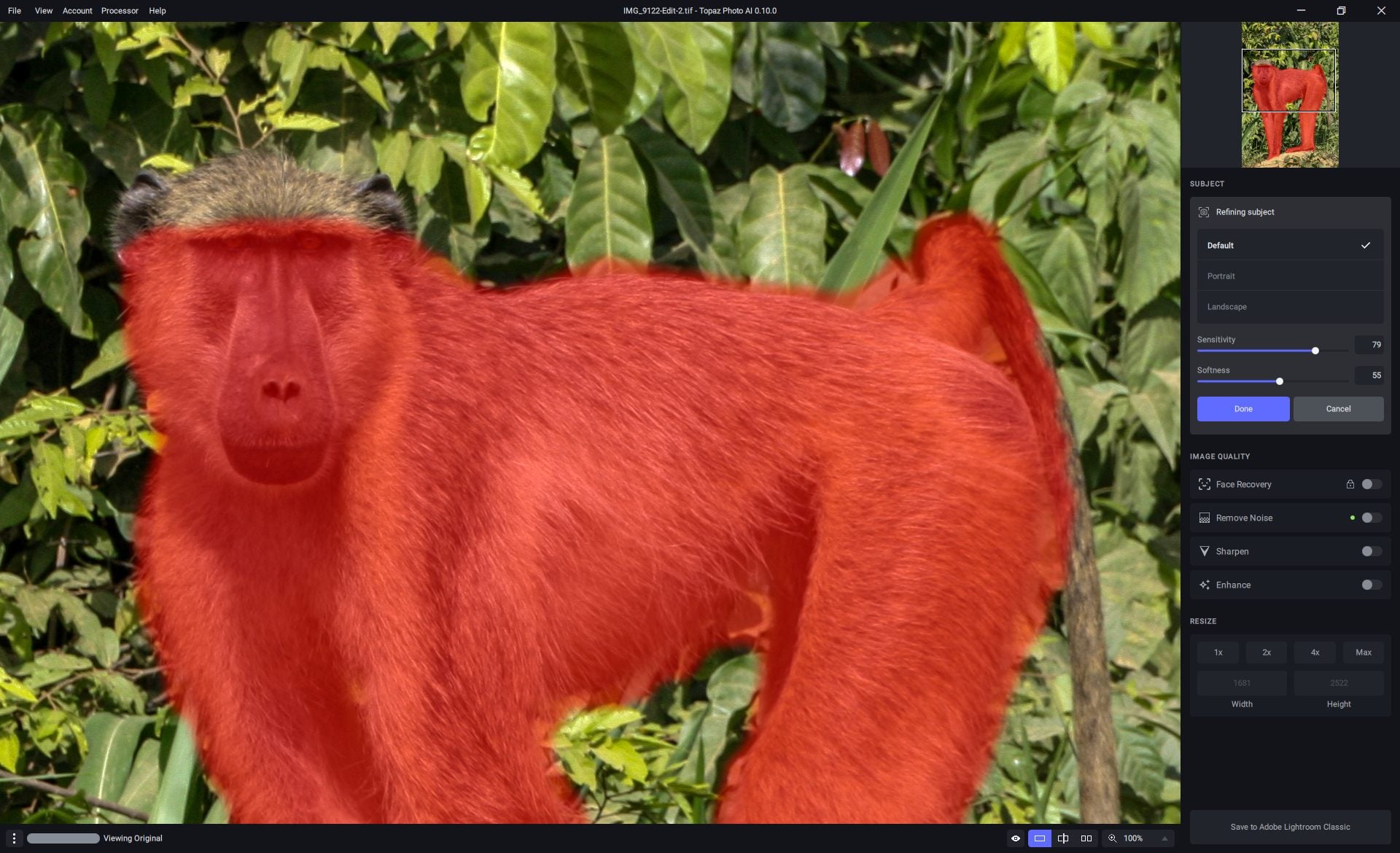

Trying to use subject detection and part of the ape’s head wont be detected. Tried even 98% to no avail. Let alone it’s tail, but that is not in focus on complicated background…

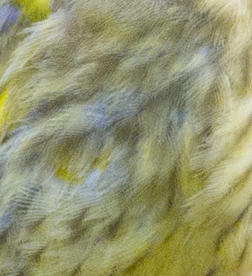

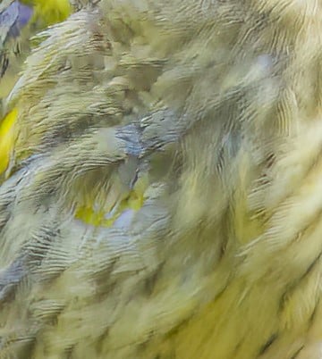

The sharpen seems far to aggressive , this is set at sharpen 1
Original
Sharpen Set at 1
