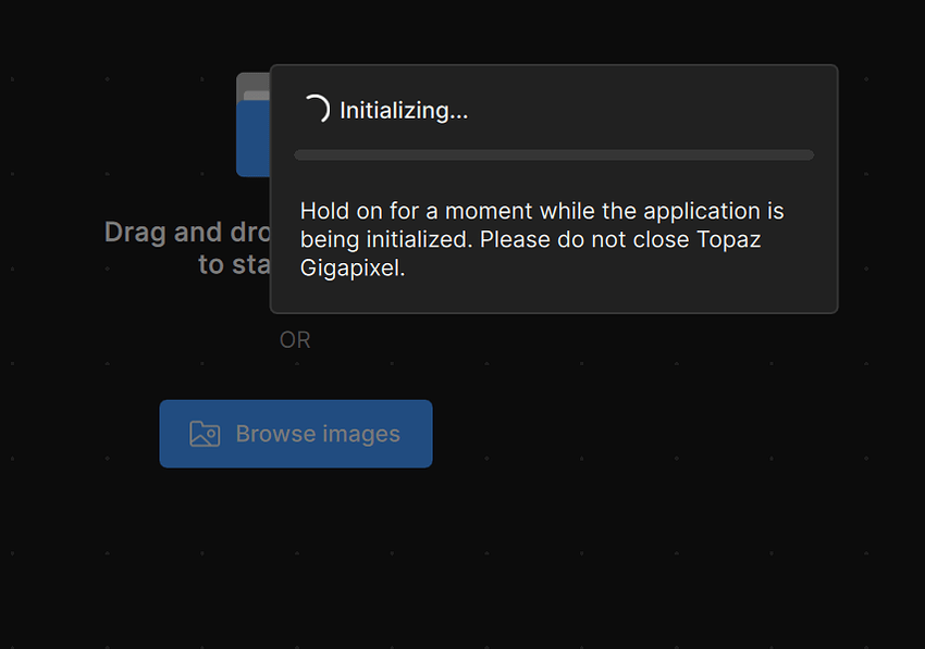

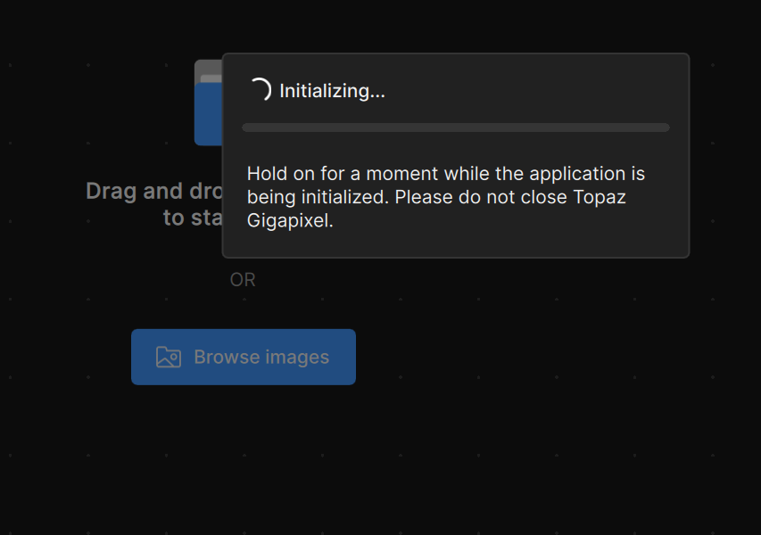

after confirming that i am logged in, gigapixel 1.0.1 is stuck initializing
I could fix it: there was a bad model path in the registry:
Computer\HKEY_LOCAL_MACHINE\SOFTWARE\Topaz Labs LLC\Topaz Gigapixel
some\path\Topaz Gigapixel\models
instead of the correct version
