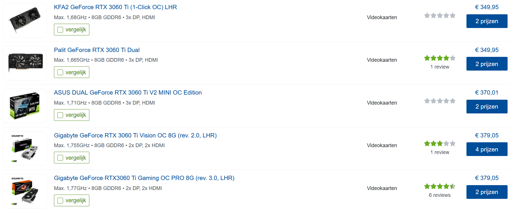

Ahh! So defenitely the 3060ti.
I don’t know why they state different clock speeds.
Which one would u go for? Just the cheapest?

From whatever I might choose… would you do new or used? Or does it depend on if it was being used for mining?
For example the 3060ti starts at 375… 2nd hand I find them for 200 - 250
Could save me 175EUR
Cheapest 3070 New , is 475 EUR

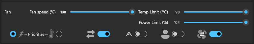

Last tip for your 3070, install MSI Afterburner, puch teh slider to 104% and that’s it. It will automatically overclock your board according to its abilities.
Oversample : Change resolution upper that the goal resolution, that’s all. It’s a trick to uncover the details :wink:
Thanks! I have changed the parameters.
Why didn’t they set it to 104 by default? :slight_smile:
