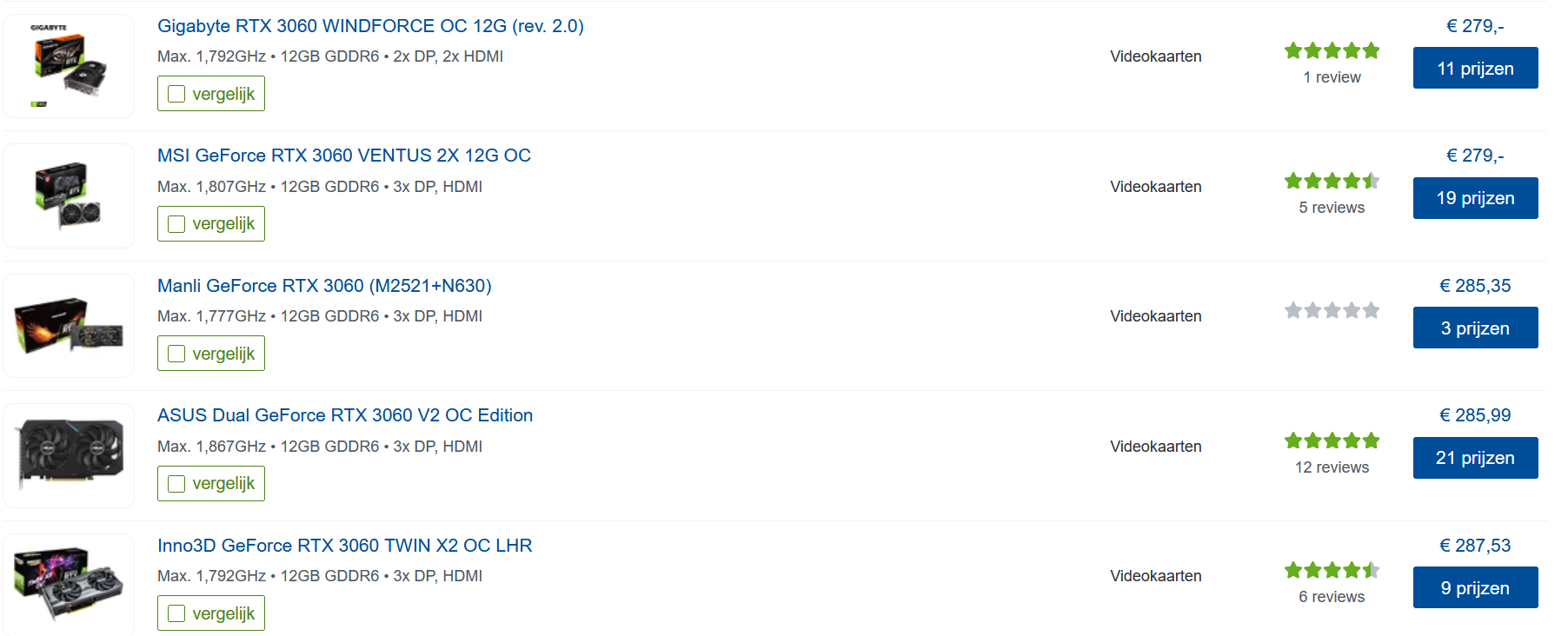

Thanks for your response! Can I pick the cheapest brand or is there any difference?
There shouldn’t be any real difference in performance. Nvidia has basically made sure of that. There might be a difference in customer support. I avoid some big brand names because of that. That’s not a factor when buying used though.
The cheapest are Asus and KFA for 350 - 370 Eur
And some are even the double
So it’s only for the brand name people pay the double? What a waste of money. not?
I don’t know what’s going on with those prices. Maybe the sellers spent too much on stocking those years ago, and don’t want to take the loss, even though the value has gone down.

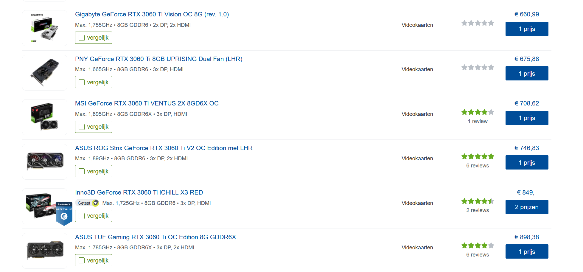

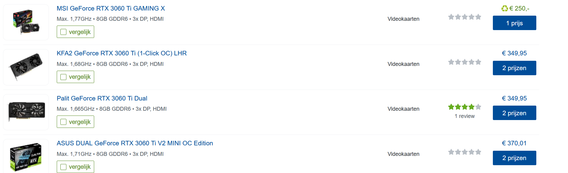

Ahh! so I just take the cheapest one. KFA2 for 349 or Palit for 349 or maybe the refurbished for 250
But I see different Max clock speeds? And for example the Palit is written behind it " Dual "?
But I see the 3060 without TI has more ram. and is cheaper hmmmm…

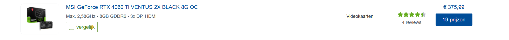

And the 4060ti is 375, just 25 euro’s more expensive than the 3060ti

I now see that the 4060ti and 4060 probably won’t be compatible with my PSU. So I think I have to stick with the 3060ti or 3060.
