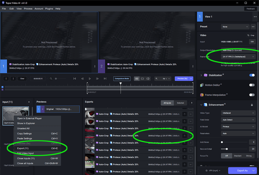

Duplicated the issue:
INPUT: Interlaced 1080i (29.97) that you want to debob / deinterlace and upres to 4k 59.94fps
OUTPUT: 3840 x 2160 at 59.94
THIS METHOD WORKS:
Open a list of files in the input tab
Get one file on the list looking perfect (2x Upscale + 2x Deinterlace + Proteus “Interlaced” )
Copy and paste these settings to all the files in the list
Export As (and click ok) for each file individually to export them one-by-one
All the Files export at 59.94 as expected
THIS DOESN’T WORK
(same steps as above BUT)… instead of pressing “Export As” for 11 separate files:
  • select ALL the files in the list (with with CTRL + A or use “Select All”)
  • Choose “Export 11” (I had 11 files, but it fails with any number)…
  • The files add to the list with Video Output Framerate reverting back to “1 x Interlace”, instead of the chosen 2 x Deinterlaced mode. The output is also at set to 29.97.
Note this is for new Proteus “interlaced” mode. (perhaps in previous versions, where interlaced was not an option for Proteus, the UI reverts back to native 1x as a safety?) Thanks!

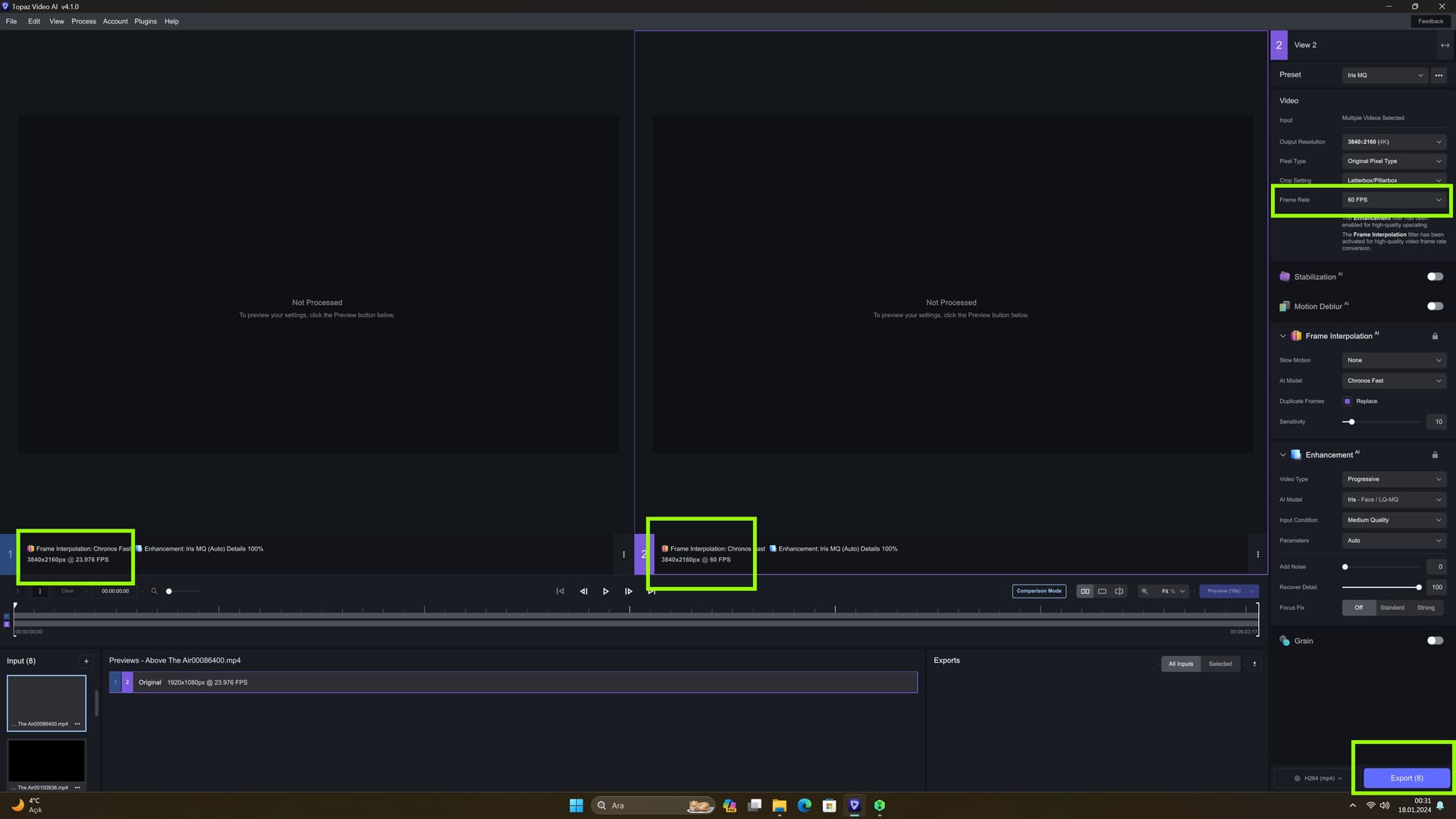

I have the same problem and prepared some detail below but realised this topic is already opened:
Hi,
Topaz Video AI has a annoying bug. When you want to process several videos in a row with the same settings, Topaz ignores your setting for the frame rate and uses the original frame setting of the input file. Even though you have changed the framerate setting, when you press “export”, the framerate setting is corrupted. For example, if you convert 8 video files from 1080p/23.96fps to 4K/60fps, the output files are rendered as 4K/23.96fps. But if you render a single video, everything works fine. AI rendering can take a very long time depending on your hardware. I want to render video files at night when I’m not using my computer, but multiple processing is not possible. You can see the attached screenshots. I hope this bug will be corrected. Thank you in advance.
