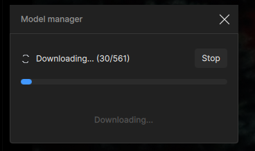

The logs are showing that the app is not getting to the actual processing stage as it seems to get hung up trying to download and queue up the models.
Open the Model Manager inside the app and let’s make sure that the models are downloaded for the app to use.
Click on the File tab in the top left corner, then scroll down to Model Manager.
You will want to make sure that the box for Enhancement is checked and the same for Frame Interpolation since those are the two areas you are wanting to apply. This will make sure that every model is downloaded in those categories.
Then click confirm and that will start the manual download of the models to your computer.
This can take a bit depending on how many models are missing, so grab a coffee and come back in a bit to check.
Once those are down downloading. Try loading up the file again and hit to export it with the settings you want to use.
If you get an error again, please pull the updated logs and send to the support team directly so we can take a look.

Hi thanks for your help and time.
It is running ok now!
Thanks again. :smiley:
Anytime, glad that it is working again for you.
