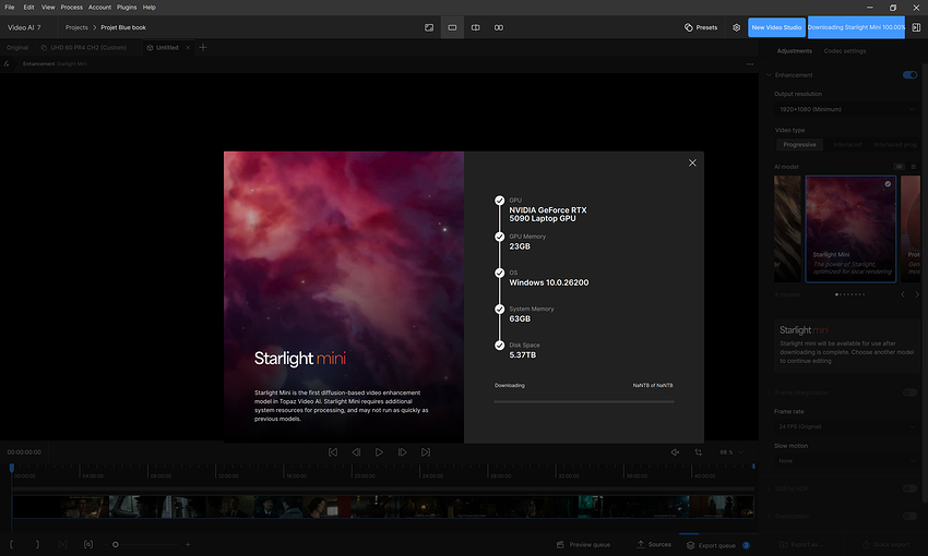

  1. Import one file;
  2. Enhancement: enabled;
  3. Select for the first time: Starlight mini;
  4. A system check is occuring automatically;
  5. As the system check is okay: Download Starlight mini.
You get this panel with insane values:
You may notice:
Downloading NaNTB of NaNTB
Also, when completed, there is an unzipping process.
The downloaded package is checked and unzipped.
The unzipped process is stuck to 100 %.
Nothing happens next and Starlight mini is not functionnal.
Tried two times.
Completely defective.
100% section took 20 minutes for me. It was a little bit miss leading.
