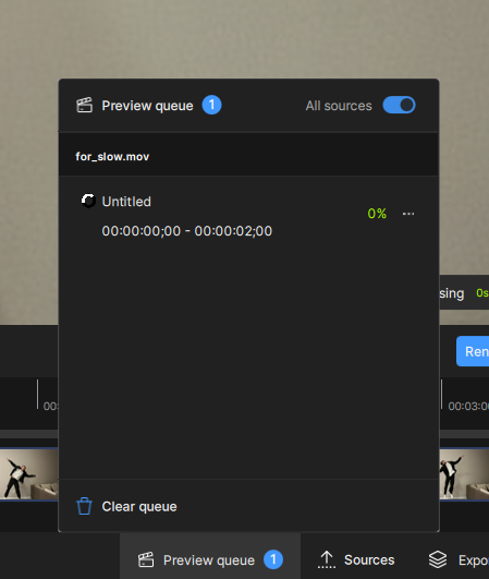

Just installed the new update, this issue is still here, also now my previews doesn’t work, it always shows 0%
logsForSupport.zip (772.1 KB)
The logs are showing that the preview is not starting as it is missing a metadata tag. Are you seeing this with other video files or just this one?
i’ve already rolled to that old version, which work perfect, I couldn’t even render the video, but at that old version I used the same file and everything was fine, I didn’t have that Issue with the preview window.
