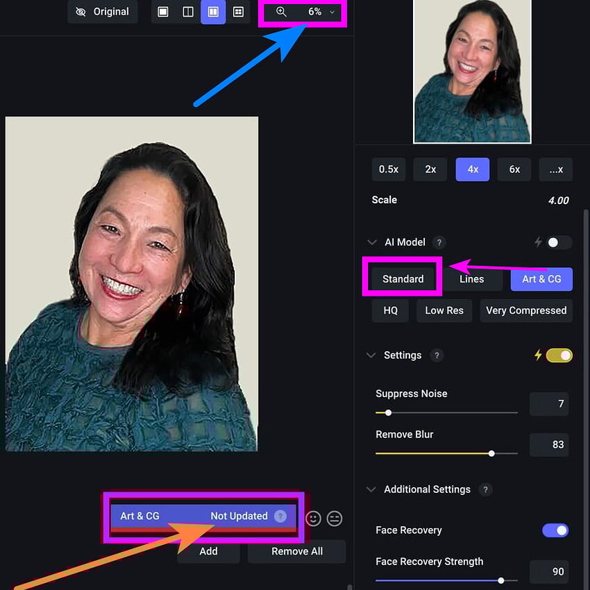

Yes, here is a screenshoot from Gigapixal.
There is still a lot of obvious blur around the teeth and eyes.
Hi jkrigs. I have some questions about your screenshot
The image Scale is set to 4X
What was the original image size, for instance is it a passport photograph
I see the AI Model is set to Art & CG
Have you tried Standard or if it’s a small image try Low Res or Very Compressed
Suppress Noise 7 good
Remove Blur 83 good
Face Recovery 90 good
Yet, the side by side comparison images look the same that’s because if look below the second image you’ll see it says Art & CG Not Updated
This seems to be the problem your preview isn’t updating and that’s why you can’t see any change
jkrigs, you could try one of the other settings I suggested see if that works

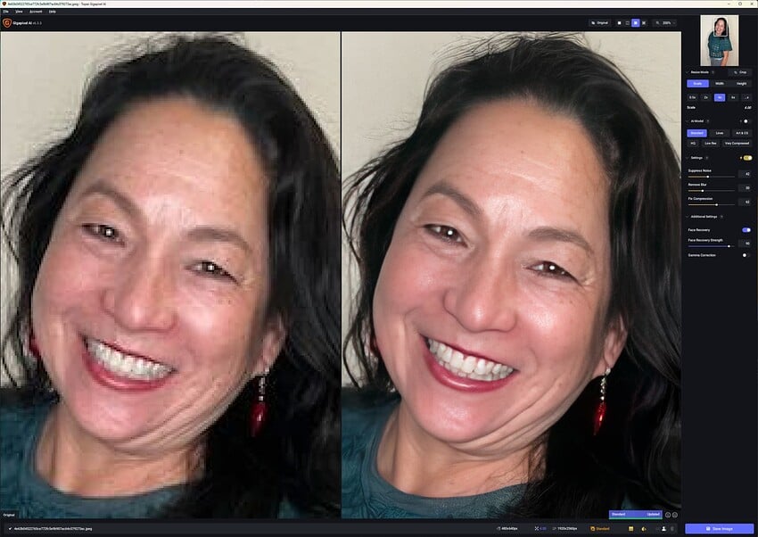

I tried sharpening a source image, and for some reason the update automatically happened. So at least it’s now up to date.
That looks so much better! How did you achieve the result?

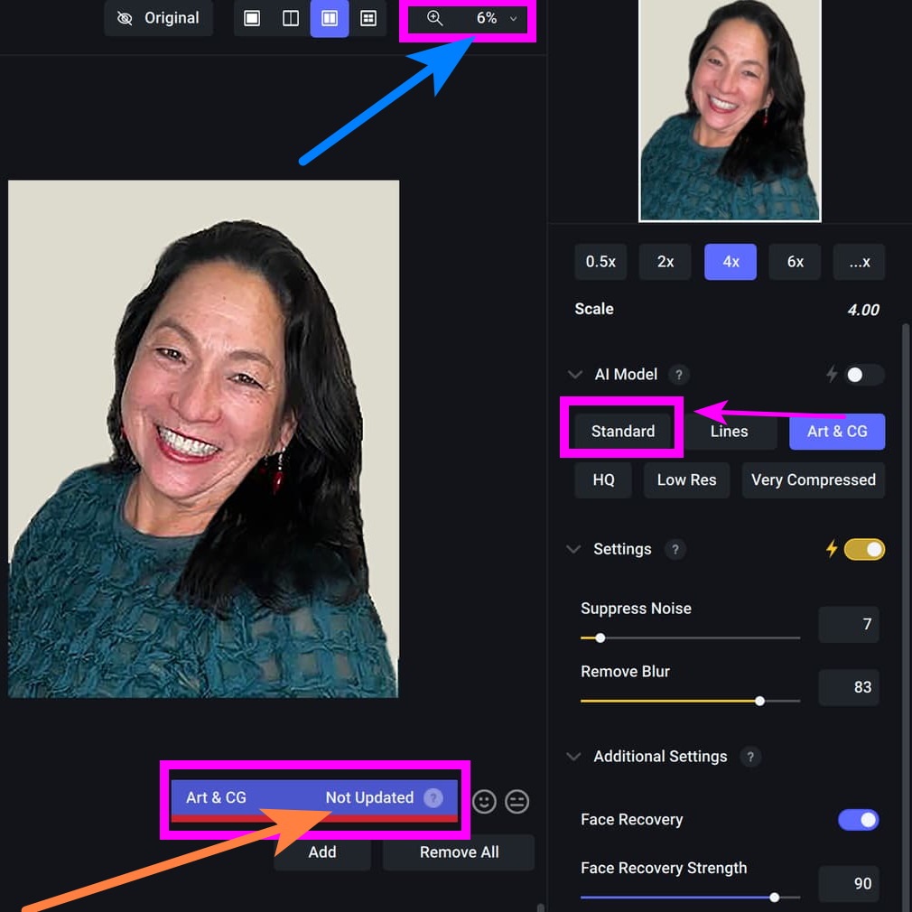

  1. AI model: Art & CG are for computer graphic, for real person, it is better use Standard model.
  2. The preview is “Not Updated”, that is why you don’t see any improvement.
  3. The zoom ratio, better set to 100%.
Here is a screenshot at 200%

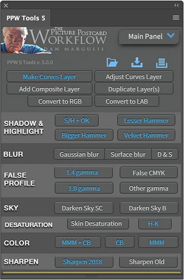

While I’m here, here’s another free Photoshop plug-in, I thought you might be interested in
Modern Photoshop Color Workflow by Dan Margulis
[http://www.moderncolorworkflow.com/wp-content/uploads/stuff/free/PPW_5_CC_112319.zip](h
Also, here’s a link to the YouTube videos that describe how to use this PPW Panel
https://m.youtube.com/watch?v=HTEXcp_JObc&list=PLr5Fd-
