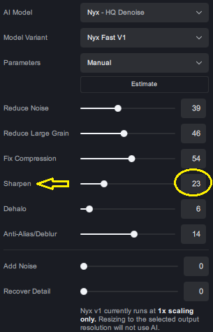

it appears that Sharpening values do not register in the Metadeta of the video. there isn’t an entry for Sharpening.
I tested on Nyx Fast, not sure if other AIs are effected by it as well or it is only limited to Nyx Fast.

I don’t think logs are necessary for this one, just run a Nyx Fast test with sharpening values set (like my picture above) and see if it applies the sharpening in the rendered file metadata. very simple to reproduce.
@kyle.topazlabs You don’t even need to test it. you can also see if you open the command that videoai.dll doesn’t attempt to add sharpening info to the metadata…
it is clearly a bug and no logs needed, you have it Infront of your eyes.
ffmpeg “-hide_banner” “-t” “52.11873333333334” “-i” “Y:/20150817195918_all.avi” “-sws_flags” “spline+accurate_rnd+full_chroma_int” “-color_trc” “2” “-colorspace” “2” “-color_primaries” “2” “-filter_complex” “tvai_up=model=nxf-1:scale=1:w=720:h=480:preblur=0.14:noise=0.38787799999999995:details=0.456128:halo=0.06:blur=0.229831:compression=0.54384:device=0:vram=1:instances=1” “-level” “3” “-c:v” “ffv1” “-pix_fmt” “yuv420p” “-slices” “4” “-slicecrc” “1” “-g” “1” “-an” “-map_metadata” “0” “-map_metadata:s:v” “0:s:v” “-map” “0:s?” “-c:s” “copy” “-movflags” “use_metadata_tags+write_colr” “-metadata” “videoai=Enhanced using nxf-1; mode: manual; reduce noise at 38.7878; reduce large grain at 45.6128; revert compression at 54.384; dehalo at 6; anti-alias/deblur at 14; and focus fix Off” “Y:/20150817195918_all_nxf1.mkv”
Thank you for sharing that, I tested on my end and see it as well. I have notified the team to address this.
