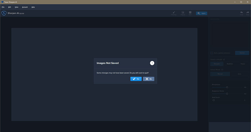

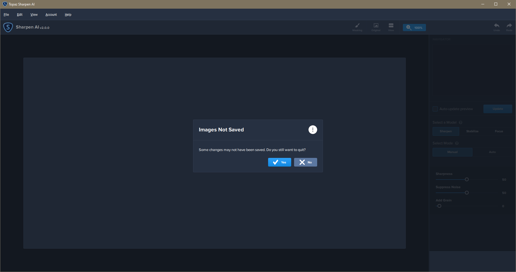

 seems like there is an issue on exit. In this case the image was processed and saved, then I clicked on the X to exit and received this message even though there were no images open.

  4. The warning message mentioned earlier by AiDon still appears even when no image is loaded when you exit.
