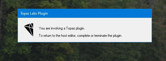

Here I am again: After the update 2.0.1 the plugin did not work in PSE 22 nor in PSE 14, even if it shows in the filters. The same after updating to 2.0.4.
I got this error message:
Topaz Fehler
I had to close PSE 22 with the task manager.
I copied the AI8bf file as instructed, but to no avail.
It works with PSE 14, but first showing the error message, 10 sec later it opens TPhoto AI.
Is there an easy solution for this issue?
Thank you
John G.
When you see that message, you’ll have to navigate to Photo AI and finish processing and export the image back into Photoshop.
