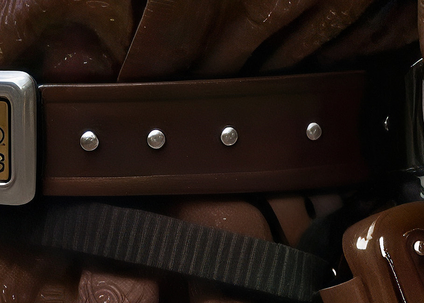

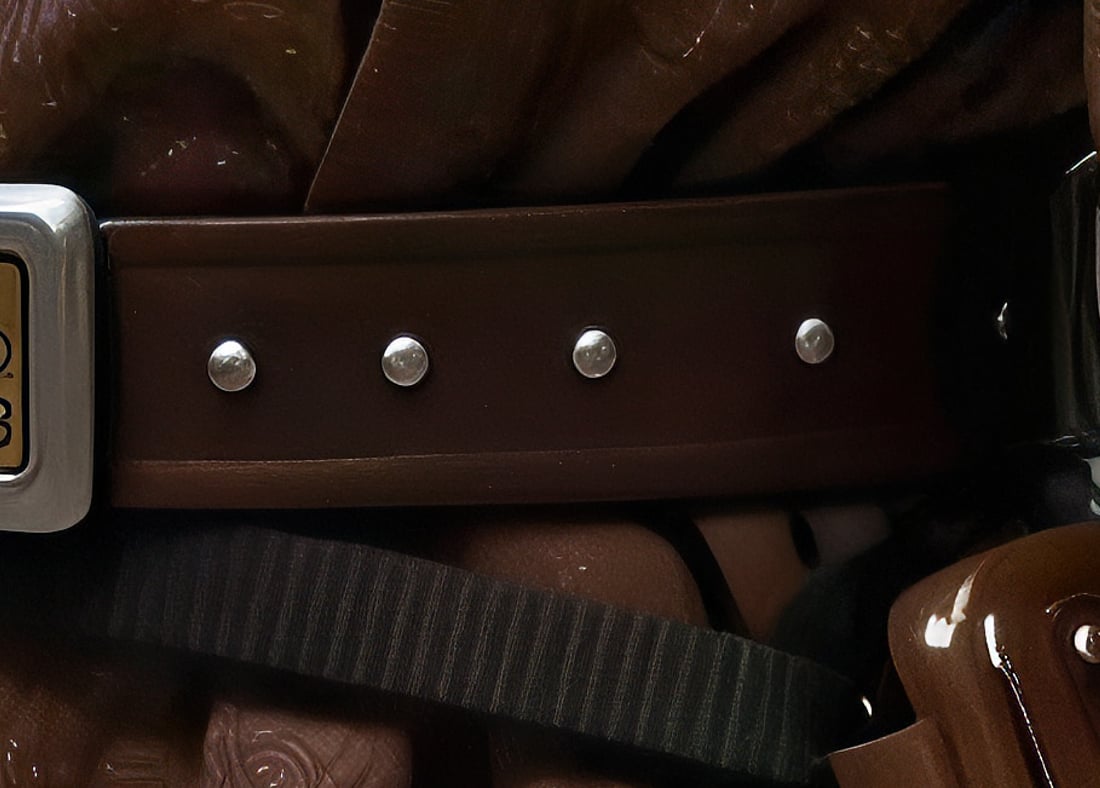

So here’s what happens when I multiply a portion by 2, knowing that I get this result if I multiply the entire image.
And now, look how much better it is with the x4
But look at the resolution of the output image I have to deal with for this. I’ve never seen anything like it before.

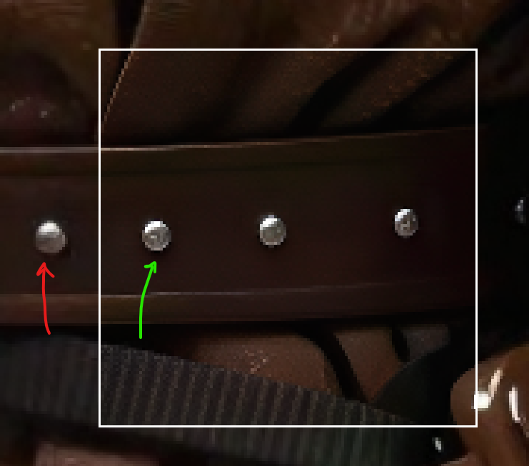

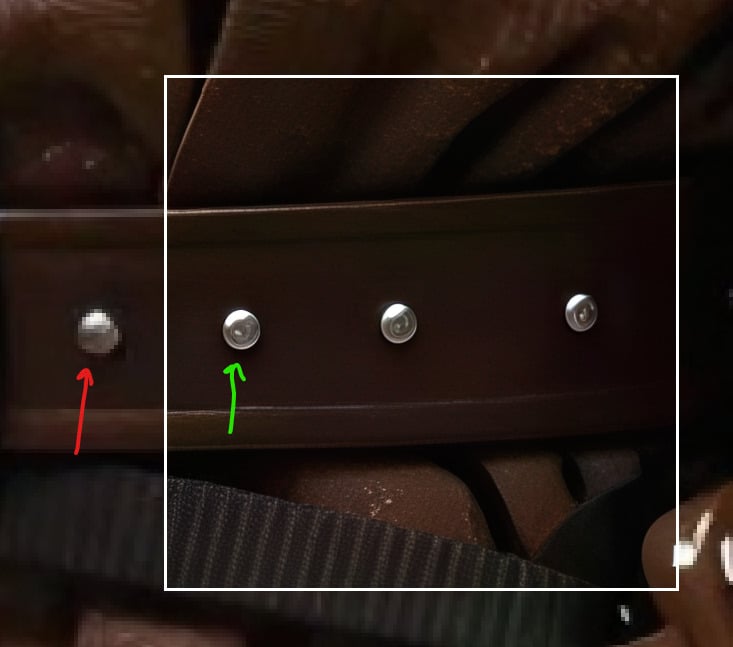

Also, to better observe the problem, here is a test between the result of the preview in small mode and the preview in large mode.
Look how well the details are on the pattern or on the writing or even on the chrome decoration on the right of the photo with the small preview.
And now look how awful it is with the full preview. (By the way, when I preview the entire image, it’s the same quality as the full preview.)
It looks like I used the medium or high settings in Recover v2. The modification on the sleeve of the black coat is just awful. I’ll try again with version 8.4.4. But I’m sure the result will be better with the same settings.

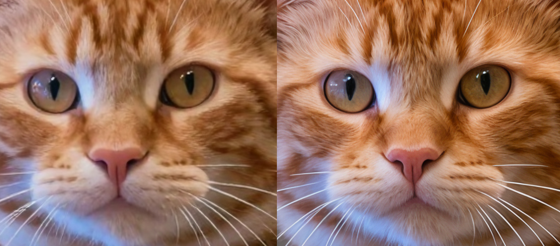

Testing that image, I get better results with 2x than the original. The quality is not degraded for me:
1x
2x
Of course if I choose 4x, it’s even better, as there are more pixels:( However, some artifacts start to appear)

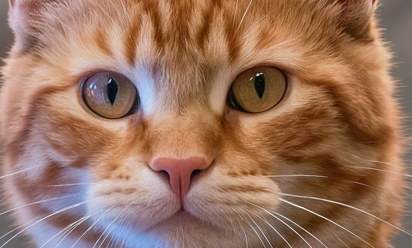

For the fur, I prefer using Redefine with AI images, it gives me better results.

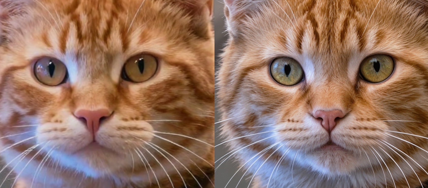

Redefine Realistic, 2x:
Redefine Creative, 2x:

For fur, yeah, I also use Redefine. I noticed in your test that the Redefine Creative mode seems to give a very natural result on the fur. On mine, I used the subtle Realistic Redefine. So with Prompt. It kept the same saturation and contrast as the source image. But I had better eyes, that’s for sure.

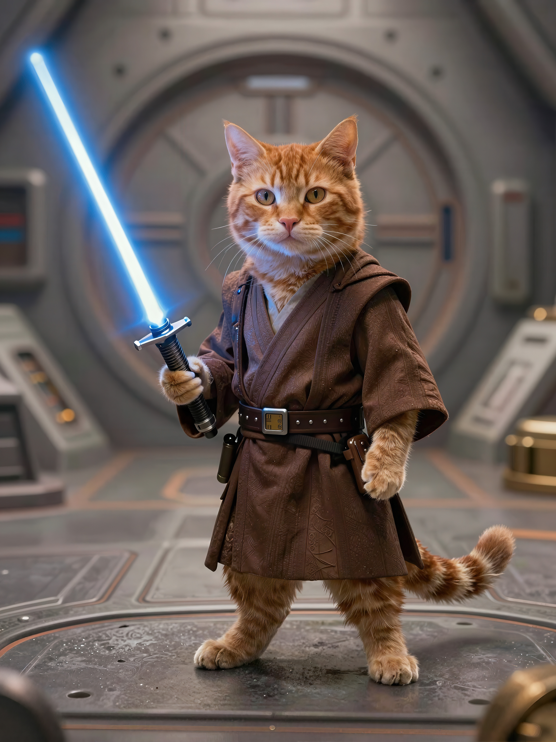

My workflow consists of 3 or 4 improvement variations using several models. Depending on certain details, one model will be better than another. Here is my final result, which I completed a week ago.
For the eyes, I improved the sharpness with the TPAI Sharpen Wildlife model. It’s really good for fine-tuning micro-details.
The fur isn’t 100% perfect, but I enlarged it quite significantly to achieve a final resolution of 8160x6120. That’s approximately 50 megapixels.

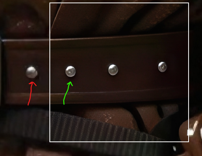

A note on cropped previews
Since these are generative, or diffusion-based models, different inputs will always create different results. The small preview will create different results from medium and large and full image renders.
Knowing that this experience caused confusion for users, there are no cropped previews for Wonder & Standard Max.
I recommend never using cropped previews as their results cannot be implemented with the final export and their results do not reflect results you’ll receive with final exports.
