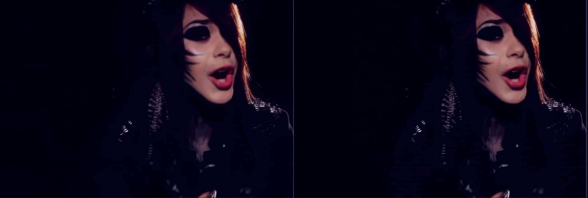

picture 1 - the preview from Topaz - Nyx 720p left - proteus 1440p right -looks fine!

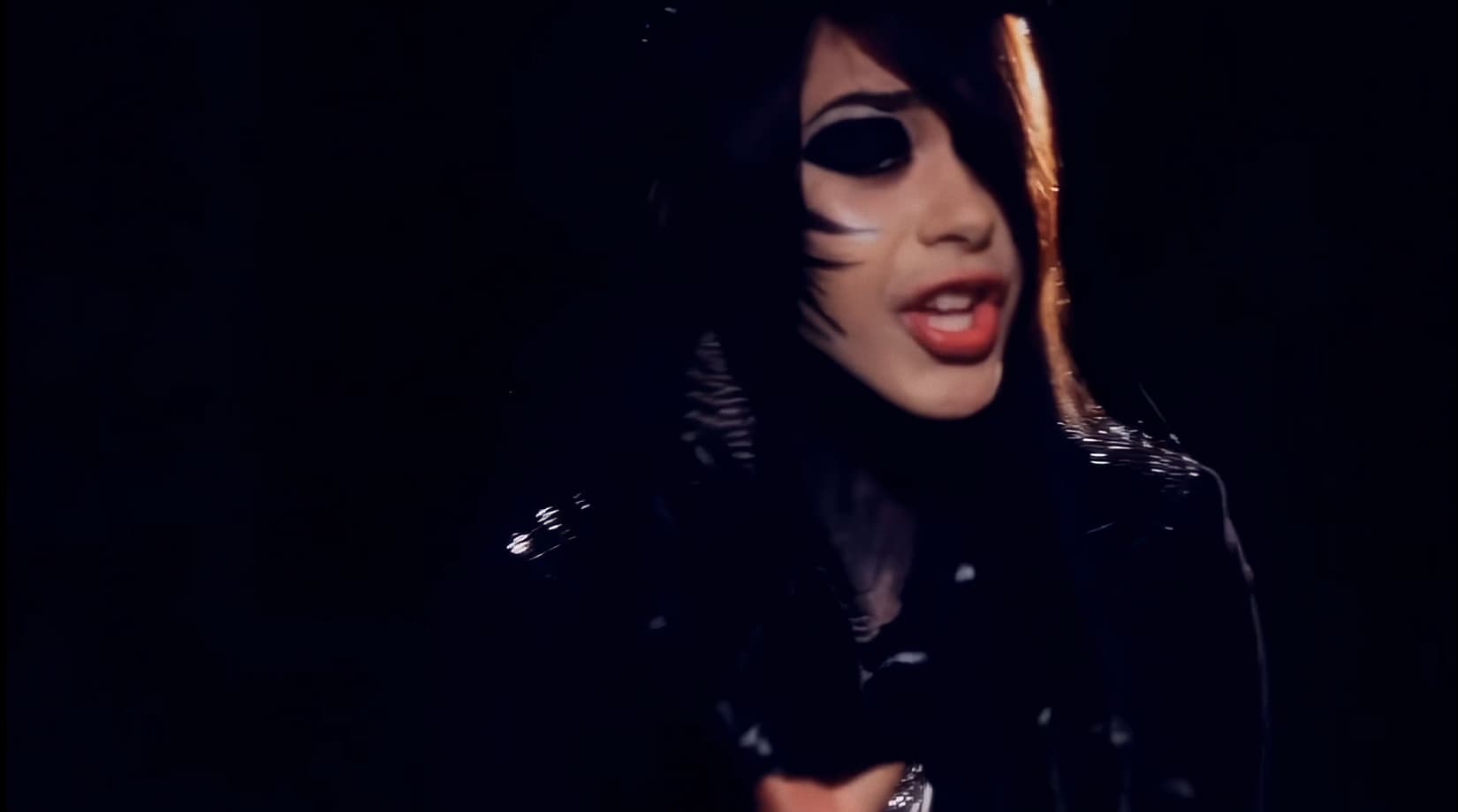

picture 2 - the end result - dark background compressed to death with color banding

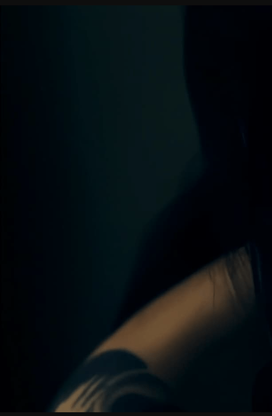

picture 3 - exported nyx 720p - (looked much cleaner before uploading it here…)

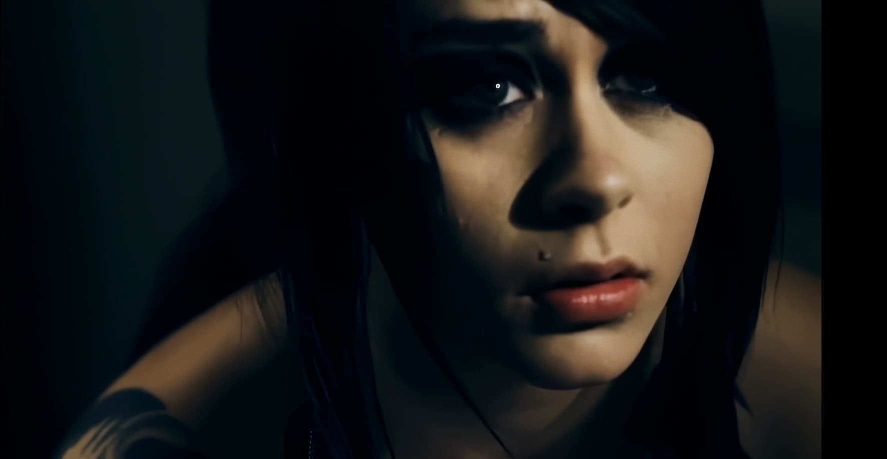

picture 4 - exported proteus 1440p

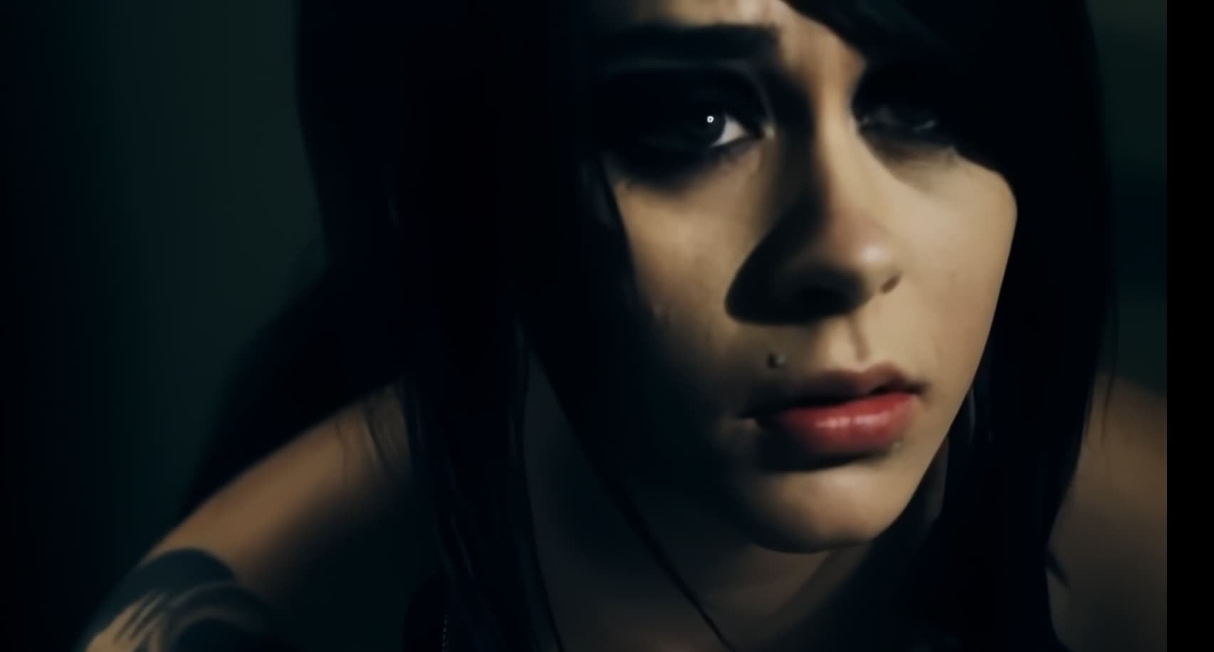

Please look, this is the png screenshot i made from the 720p nyx video

When you compare picture 3 from my first post to the picture i sended later (the png) it is basically the same effect as with the video. Its like the video is compressed to jpeg and the preview was the png.
