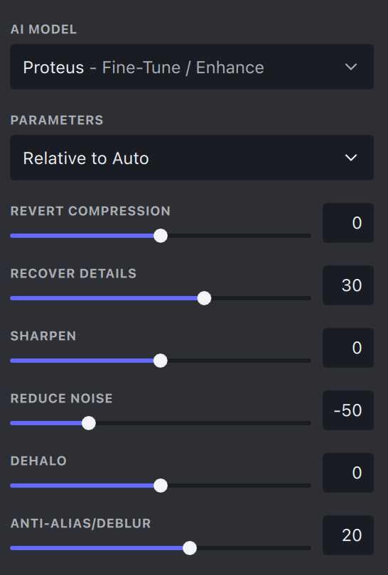

Most of the time I go with these settings which gives me better results than Auto
Screen Shot 2023-06-14 at 11.11.00 am
The settings required are different for each video, and in many cases, different settings must be done for different scenes in the same video.
Proteus auto and relative to auto are very well suited to ā€˜automatically’ making changes from scene to scene. But Proteus auto or ā€˜1relative’ auto aren’t perfect. There will always be instances when the user must step in and make special settings.
agreed. This is why I find some minor adjustments provide good results. For example. Auto tends to boost the noise reduction parameter a bit too much which results in lost detail.
I think that most of the enhancement algorithms the use, including Proteus, are somewhat conservative when it comes to their ā€˜automatic’ video compression setting.
At the same time, I know that pushing decompression too hard can result in image degradation. -Perhaps the reason they aren’t more aggressive with decompression levels is simply to ā€œerr on the side of caution.ā€
However: Compression vs. Quality - Iris vs. Proteus
Well, the detail setting is really part of a dual control situation. That is Reduce Noise and More Detail work in sort of a push-pull relationship.
Reduce noise should be turned up just high enough so the ā€˜speckles’ caused by decompression noise and (in some cases) old film grain. Turning this up too high can take out image detail. Conversely, if you turn detail up too high, it will actually ā€˜invent’ detail into the image. (Which can also be a blessing or a curse.)
This is my way of dealing with noise in Proteus (and probably Iris, too.) Turn the Reduce Noise up just enough, so the little speckles are detected and removed. (The still background areas in the image become ā€˜quiet.’) Following that is the best time to boost detail sufficiently.
