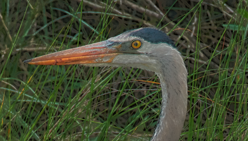

I have tried multiple things, including a reinstall. I have attached two sample images. The clear image was immediately upon opening Studio. The other is after applying Precision Detail before doing anything else. I have tried at least 7 images and all with the same result. I tried adjusting once it was open with no success.
