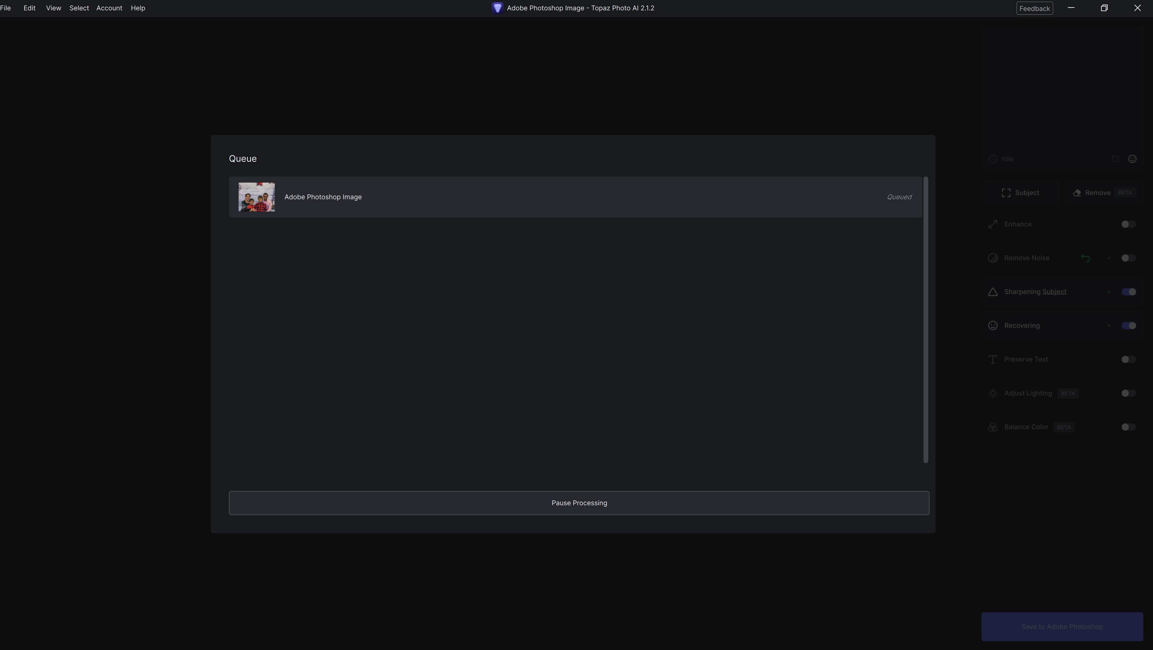

  3. When run as an action (needed for batch process) action/Topaz Photo AI lock up:

I have the same problem. I used Photo AI in photoshop within batch processing. I find out that the problem is that the save button is enabled before the photo is updated by the AI algorithm.
On the moment that the save button is active the program want to try a save of the image in Photoshop. The result is that is will hang in a queue. Resume does not work. You must cancel it.
