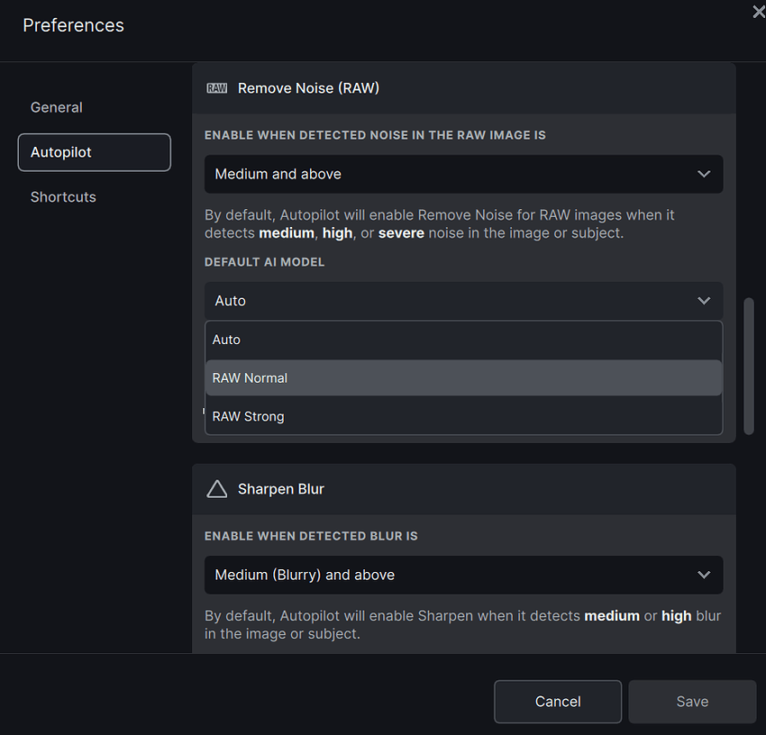

Thanks for sending the logs. It looks like the Remove Noise - Raw Strong model is crashing every time.
Please try changing the default model to Normal to prevent the crash, then try the other models to see if they have issues.
We are likely removing the v1 models soon if the v2 models are working.
Changed the Default model to Normal as suggested and so far that has worked ! :ok_hand: :+1: :+1: :+1: :+1:
Thanks Very Much
Wonderful news. We will be looking into a fix for this issue in the meanwhile.
