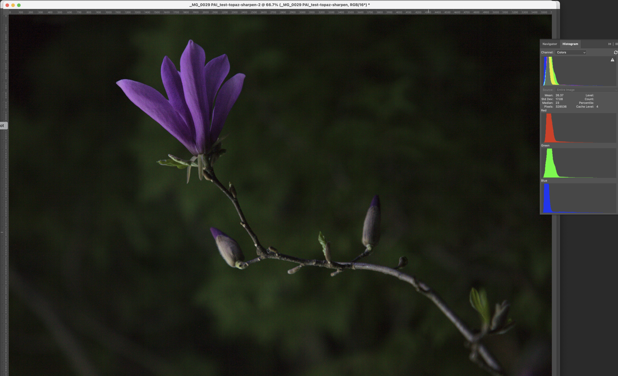

I opened these CR2 (Canon camera raw) images into Photo AI 1.3.7 via Adobe Bridge on my Mac (System Information attached), applied sharpening and (raw) noise removal. Initially, I saved as DNG (the “preserve input format” option), but noticed that the colors in the image differed noticeably from the original image (as seen in Bridge) and that there was a slight shift in the image geometry.
In an attempt to isolate the problem, I first reduced the alterations to the image made by Photo AI to a minimal amount of sharpening. Second, I also saved the Photo AI image as TIFF. The attached Photo AI log documents these two files. Third, to eliminate any impact from Bridge or Adobe Camera Raw, I opened the CR2, DNG, and TIFF image sources into Photoshop (as 16 bit, Adobe RGB (1998)). To further document the color changes, I included the histogram for each in the screenshots.
There is a significant color change between the three images. Note that I am ignoring the white specks in the corners of the DNG image; that appears to be an artifact arising from the minimal sharpening. In addition, I see a geometric shift in the image. Since this can’t be discerned from the screenshots, I overlaid the DNG on top of the CR2 image in Photoshop and set the blending mode to “Difference”; I am including a screenshot of that as well. I can use the Move tool to eliminate this shift with a few nudges up and to the left; i.e., the change appears to be uniform across the image (note that I have the lens correction option turned off in Photo AI).
Finally, with the CR2 image open in Photoshop, I ran Photo AI on it via the plug-in, applying full sharpening and noise removal. This works great; no color changes or geometry changes. A screenshot of that is included.
I expected to be able to have the stand-alone Photo AI provide this same result in a DNG file, but it’s giving me these color and geometry shifts instead.
