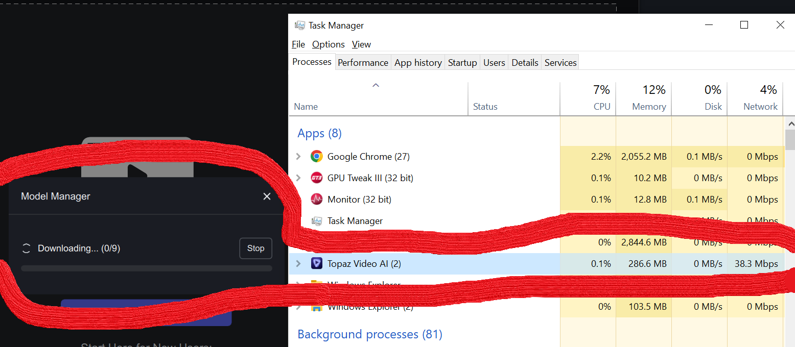

Same issue here:
Maybe a Windows / Mac difference (I’m on MacOS)?
Or related to specific GPUs / specific models? I only tried those that I do normally use: Iris, Proteus.
So: maybe try, if all models fail to download or just specific ones. Do you have a Firewall / VPN / Antivirus installed ?
@TheRustyRebel @notes4me Make sure the GUI has access to the internet, seems like firewall is blocking connection. Make sure the app has https access to the following hosts: veai-models.topazlabs.com and models.topazlabs.com
Is this what you mean or something else? In April 2023 models refused to download within the app and had to get them manually from the log files, since the 4.0 release it now downloads models if like it used to but takes 10x longer than it would if done manually. I thought the model manager would do the same job but appears to fail, if it were a connection/firewall issue then surely it wouldn’t download models while I am trying to use the software before model manager was released?
It uses up to 40-Mbps when I start the download in model manager but fails after 10-20 seconds later, doesn’t make a difference which model or how many I select either.
can you send me the application logs
