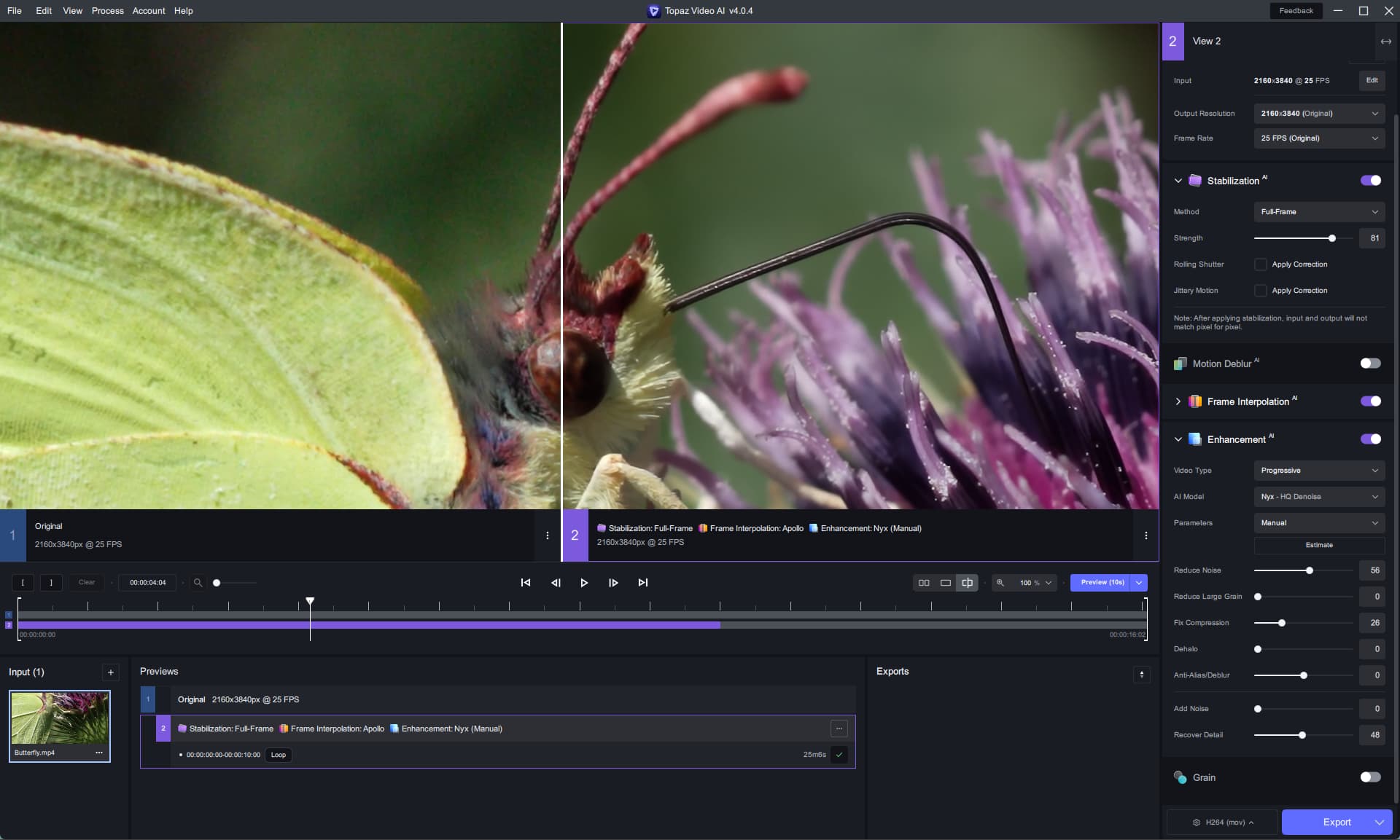

Hmmm, how was the input processed before?
Try 70/30/70 all other at default, and not relative to auto.
But why is the magnification in both images so different?

Nyx 1 (Extreme settings)
Nyx 2 (extreme settings)
Nyx 2 optimised - but i would use a more specialised software for such a kind of noise, bc TVAI has problems that are related to AI processing as such and the video would need some corrections afterwards, TVAI is made for processing already finalised videos, bc of this they made the plugins i think.
