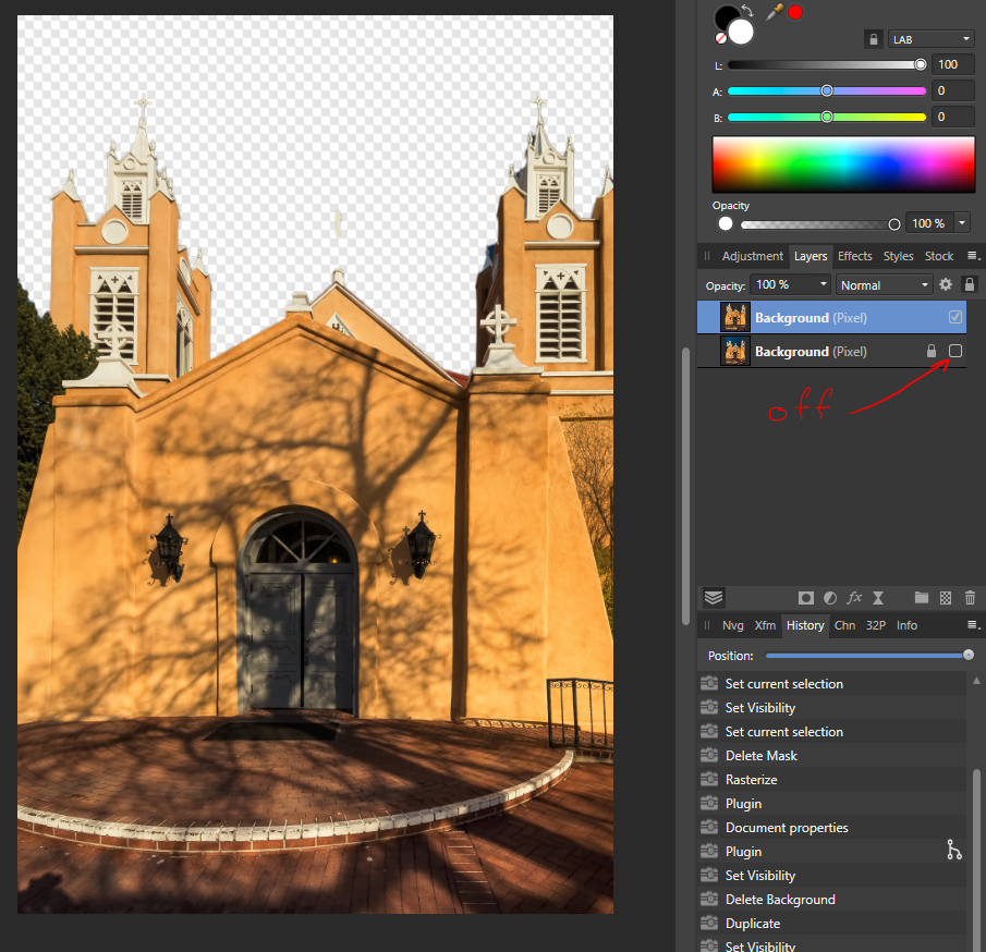

I just tried an image (below) in Affinity Photo v1.8.4.xxx using the latest Mask AI beta v 1.3.0.5b and it does return properly to Affinity. I was fooled at first because I had the main layer still visible so it show the sky in the clear part of the Mask AI returned layer. If you have the deleted part show as clear then be sure to turn off the layer/s below so you can see it .
Please try this.
1 Duplicate Layer
2 Run Mask AI
3 Apply to return to Affinity Photo, it will look like nothing has happened, because the original background is showing through.
4 In the Channels Tab you will see a channel called Background Alpha
5 Right Click on that channel and select Create Mask Layer, this will put a mask layer at the top of the layers panel
You can paint in black or whit to reveal the image in the original background layer
