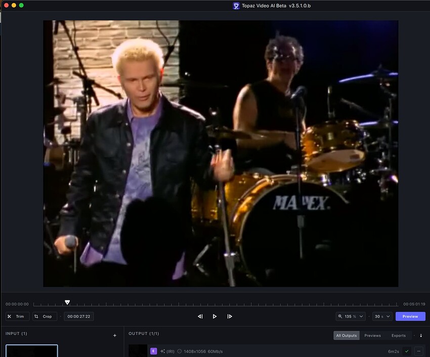

Iris 2x model extremely slow on Apple Silicon after model update
    Iris V1 and V2 are extremely slow on Applesilicon with the 2x model. Iris V1 was blazingly fast with the 3.4.0.0.a (where the release notes also stated a speed gain) but that was lost with encoding speed down back already in the 3.4.0 Beta.
    When Iris V2 was introduced it had good speed up to the 3.5.0.1.b -but with the following releases speed drastically reduced (about 60% of the former fps). Since this is now also the case when I reinstall the formerly fast 3.5.0.1.b I believe this is due to changes in the Iris model itself and not the app.
  2. Mac Studio M2 ultra 24c/60c, 64GB RAM, MacOS Sonoma 14.0
  3. Your log files (Help > Logging > Get Logs for Support)
    Since there’s no “error” I don’t think that log files will be helpful here
  4. Any screenshots as necessary
    The exact same task encoded with different versions:
    Iris V2 with the 3.5.0.1.b - 6 min 2 sec encoding time
Iris V2 with the 3.5.1 release - 9 min 54 sec encoding time
Iris V1 with the 3.4.0.1.a - 4 min 55 sec encoding time
So: where has the speed gain that was announced with 3.4 gone and why? Especially as there seems no really visible difference in the output before and after.
And 10 minutes instead of 5 minutes on the exact same machine with the exact same task definitely is a deal breaker for using newer versions.
P.S.: This seems to affect mainly the 2x model of Iris and you can see this speed anomaly also in the benchmark with the 2x model being merely faster than 4x.
