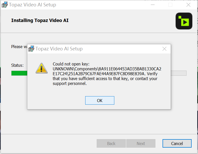

I can't update the new version
360截图20250209181351
when i update 6.0.3,i can’t install the news version, i don’t know ,why
It looks like missing admin permission with loged on user for the update, OR the Registry Key is somewhat corrupted.
open regedit and search under “HKEY_LOCAL_MACHINE” for key: 8A911E064453AD35BAB1330CA2E17C24 and check permissions of this key
Or “add remove programs” deinstall TVAI and download the TVAI setup file for a new installation.
Are you running the installer as an Admin on the system or under a User profile?
As @Mayday mentioned, checking the registry is a good option as well.
Try removing the older installation completely and clearing the Registry files using the steps below and then installing a clean copy.
  • Delete any files and folder for the main drive - C:\Program Files\Topaz Labs LLC\Topaz Video AI\
  • Open the Registry Editor on your system. - Windows Key+R will open the run option and then type regedit. Click yes when it prompts.
  • Navigate down to the following folders and right-click on it to delete it.
  • I. Computer\HKEY_CURRENT_USER\Software\Topaz Labs LLC\ Topaz Video AI. Computer\HKEY_LOCAL_MACHINE\Software\Topaz Labs LLC\Topaz Video AI
  • Reboot your system
  • Reinstall the app from a clean download using this link: Video AI v6.0.3
