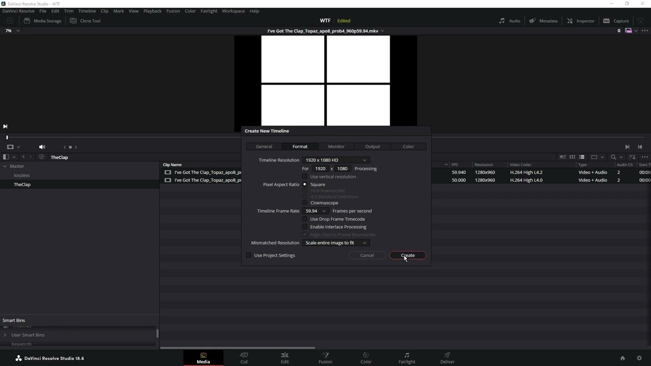

Ok, I installed the latest release of Resolve on Windows, which is 18.6.6 build 7 and I see that the shared clips come in as Video+Audio, but there is still no sound. Please crosscheck your findings.
To illustrate what I see and hear, I made this screen recording:
