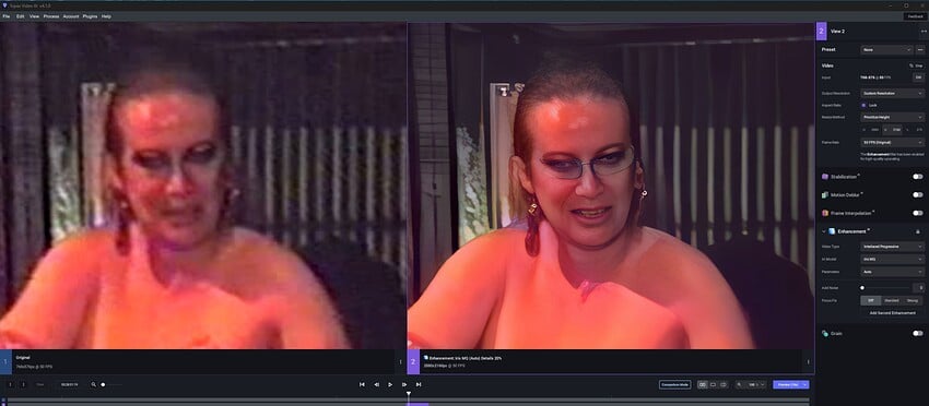

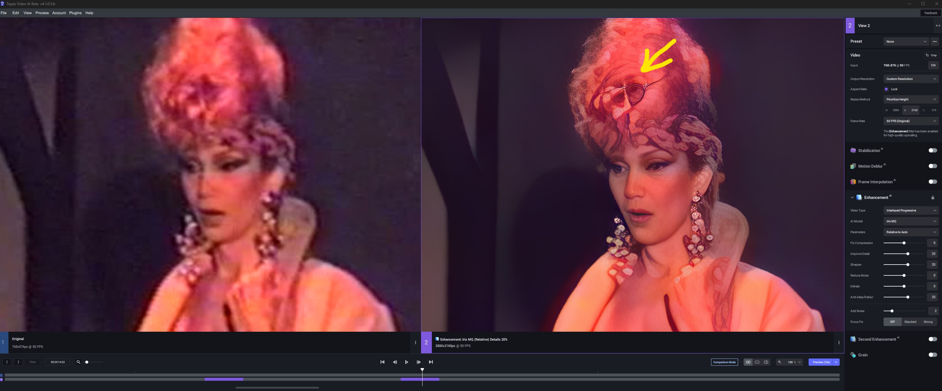

I’ve never seen anything like this before but IRIS is adding glasses to my video. It’s doing the same thing in full v4.1.0 and Beta v4.1.0.5.b. How is this happening?
The bottom picture has glasses in the hair!

Don’t blame the AI, the source quality is poor and lo-res.
Yeah but hang on, what you are saying may be the case but where are the glasses coming from? TVAI did a great job on the rest of the face! Maybe the addition of face wear should be switchable.

You asked why you are getting strange results - and the answer is, the source material is bad. The model sees patches of colour variation near the eyes and decided it was glasses. With a better quality source, it’s less likely to happen.
You used Iris MQ?
Try LQ V1 instead and with a high value for recover original details (80 or higher).
If I had better quality sources, i wouldn’t need TVAI. I upres from old VHS tapes so I need a version of IRIS that doesn’t add glasses. IRIS does a brilliant job on the rest of the face of these old videos as I have already said. Surely there can be a version that excludes glasses from the model, particularly when it is adding it to other places like in the hair.
They would have to train an entire new model to exclude glasses, it can’t just be turned on or off. I don’t see them doing that…but you never know.
LQ V1 smooths to much, MQ does a superior job but adds glasses. I’m hoping TOPAZ will give us another version of IRIS that excludes glasses from the model given the rest of the face in this instance is coming up so well.
Exactly. If IRIS is adding artifacts like glasses, which is so foreign like in the hair, it really needs to be reviewed.
It’s actually made part of the hair into a face too! :rofl:
