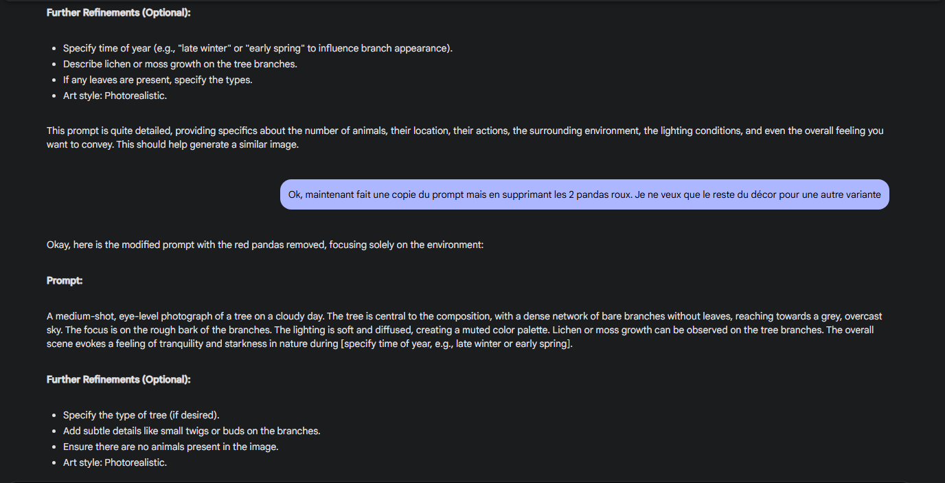

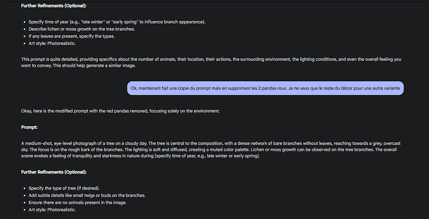

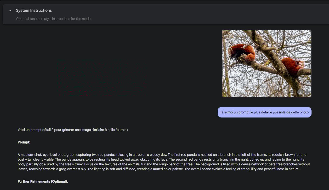

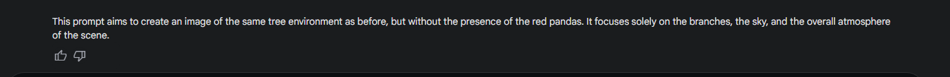

Also @unrelent for the prompt, I use Google Gemini. It’s really efficient.
Here’s an example of the photo I’m redefining.
Overall, you can see a general prompt and then a more precise prompt without the 2 red pandas for use in Gigapixel.

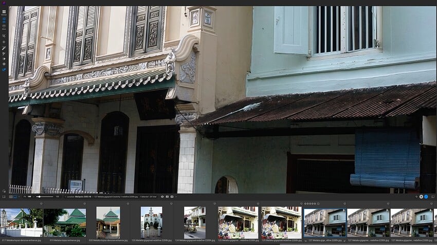

I was intrigued to read that you found Redefine Creativity 3 faster than Creativity 2.
I can indeed confirm this. My test image was taken on a fairly basic digital camera more than 20 years ago and upscaled x1.83 to 4k. Here are the results at 100%:
Creativity 1: approx 20m
Creativity 2: approx 39m
Creativity 3: approx 16m.
Recover v2 beta, with detail set to the default @75: 1m17s

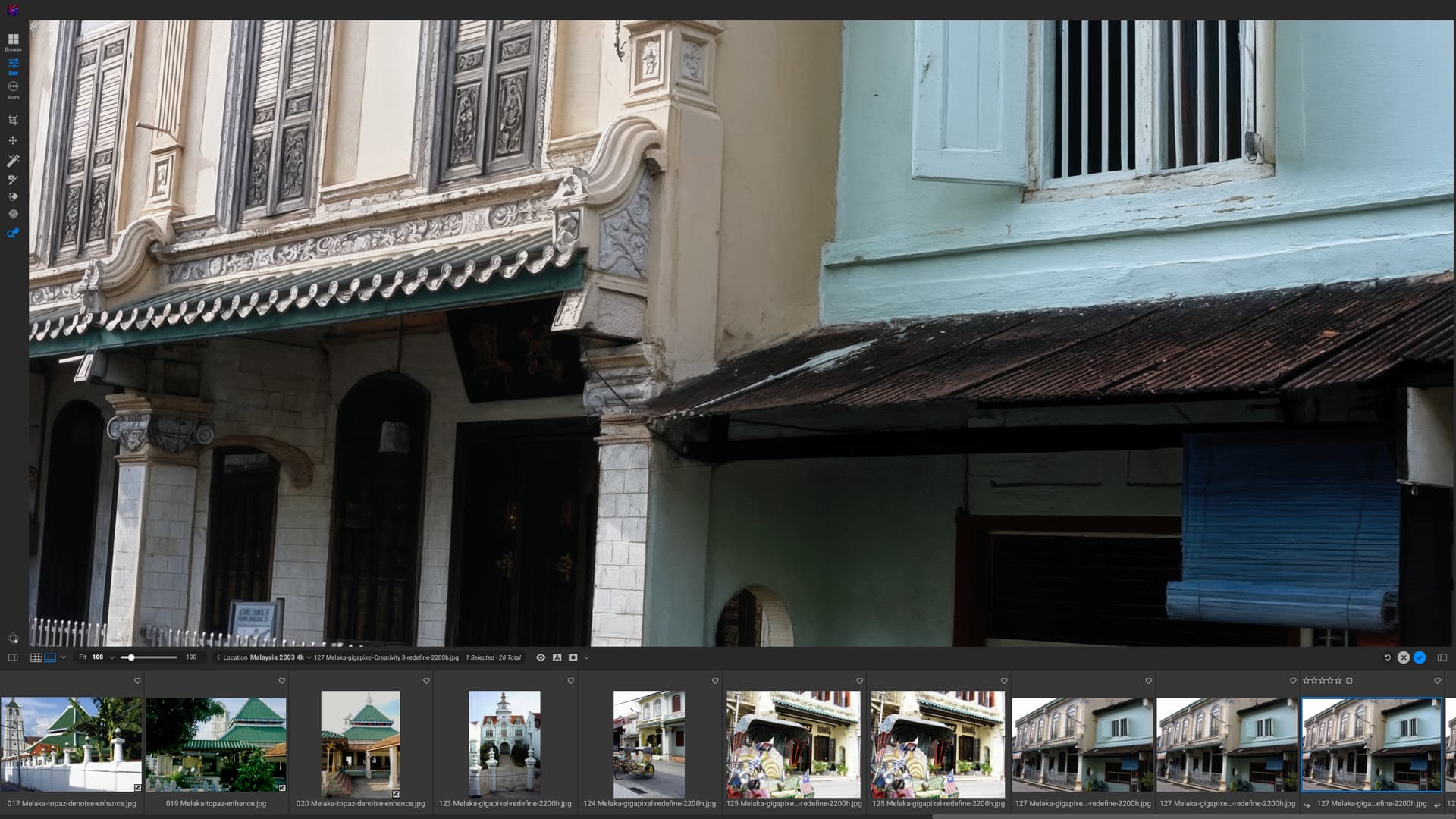

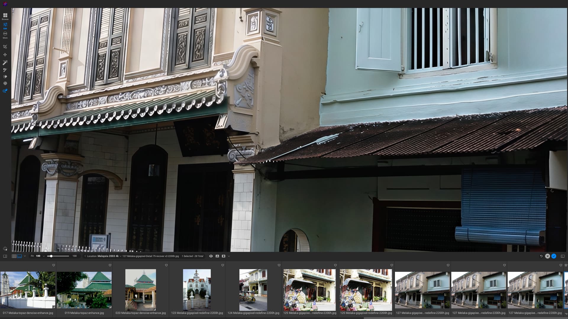

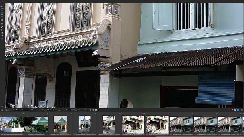

In many respects I prefer Creativity 1. Look at what I think are cutout figures of people in traditional Chinese dress. This is at 200%:
Creativity 1
Creativity 2
Creativity 3 turns them into elephants!
Mostly, given that it’s faster, I am using Creativity 1 on these old photos. Every so often, elements like grass or gravel in the foreground are rendered poorly, and I find I can improve them using Creativity 2 along with some text prompts.
