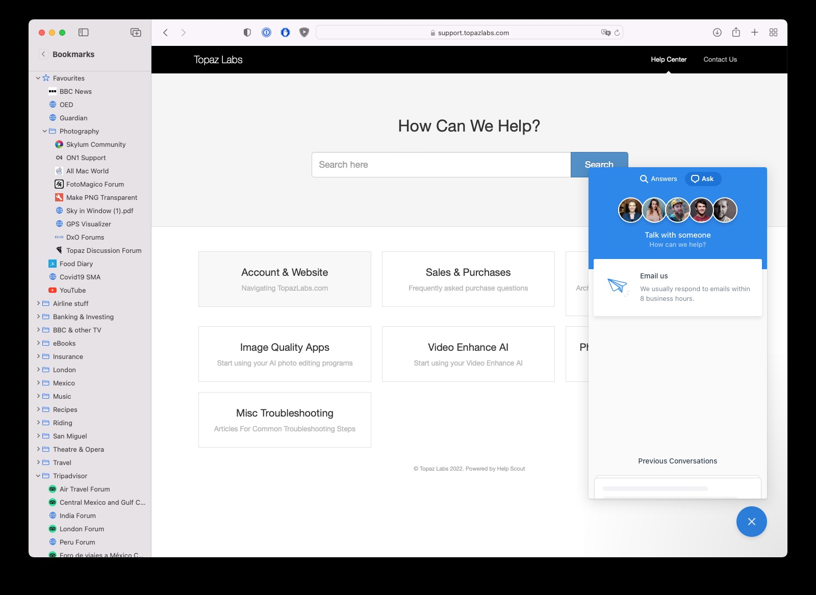

Thanks, how do you raise a support ticket?
Go to the main Topaz Labs website and click on the Contact Us button. You have the option of chat or email. I suggest email.
Thanks - will do.
