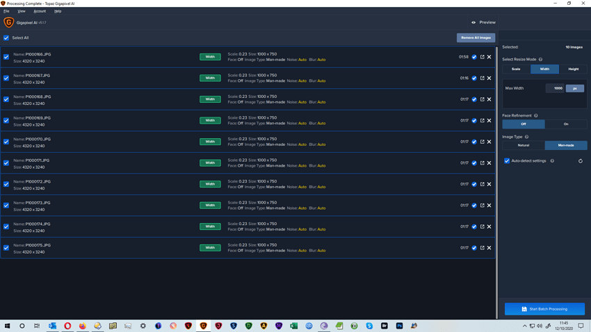

I don’t often batch process - I thought I’d noticed this last time I did but couldn’t be sure as I wasn’t really paying attention, but this time I was watching. The first image in a batch appears to be processed twice while the remainder are only processed once. This is the result of a batch I just did, all starting and finishing at the same size - note the time for the first image compared to the rest of them:
