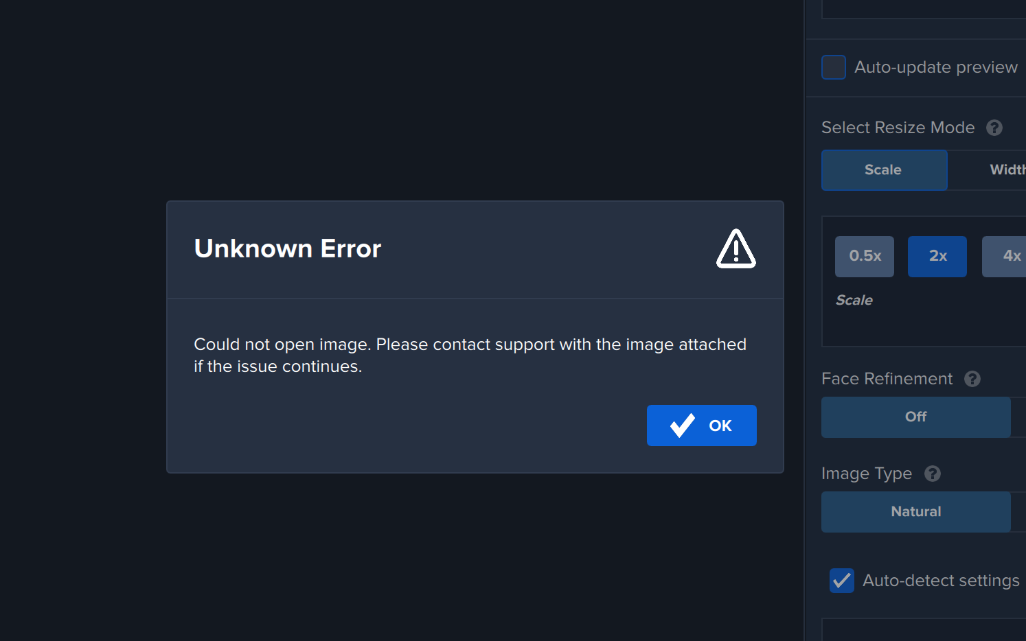

I have an issue loading Leica M246 (Monochrom) files to GigaPixel after updating to 5.1.7
I get the attached message. Regular color DNG from other Leica,
works fine.

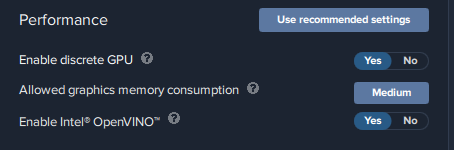

Does it enable GPU as well as OpenVINO?
If not try switching it on to have both activated, if yes try switching it off leaving only OpenVINO activated to see if that makes a difference.

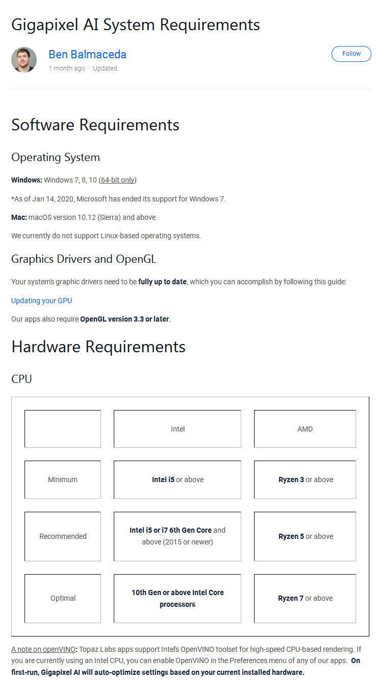

If that fails you can try raising a support request at the main website as I haven’t seen this before, but remember that Windows 7 is not supported so they may not be able to help.

I only have OpenVINO enabled when the glitching occurs. I checked the registry and the application setting. GPU options are off (there is no GPU); OpenVINO options are on. If OpenVINO is turned off, then output is no longer distorted.
I already tried going to support. They basically said as I expected, there is nothing that can be done. I know that the reality is that if no one has the issue but me, then it’s not going to be worth anyone’s time to try and fix it.
Up until version 5.1.6, calibration always resulted in GPU being disabled and OpenVINO being enabled. OpenVINO worked as there was a very clear performance boost. OpenVINO is currently working for me in all other Topaz Applications, including Video Enhance AI 1.6.1, Denoise AI 2.3.1, and SharpenAI 2.1.7.
I tried turning both GPU and OpenVINO on in Gigapixel 5.1.7. This behaved the same as having both GPU and OpenVINO disabled. So it worked (no distorted output), but it ran at the same speed as it does with OpenVINO disabled. If GPU is disabled and OpenVINO is enabled, I get OpenVINO performance, but distorted, unusable output.
From what I’ve read, OpenVINO has shown “Windows 10 only” for the system requirements for quite some time. This is for the toolkit though. It apparently worked for Windows 7 on runtime because it was working in Gigapixel up to version 5.1.6. Unless Topaz was using an older version of OpenVINO.
I take it Topaz updated OpenVINO to 2021.1: Releases · openvinotoolkit/openvino · GitHub
So I guess this means no more OpenVINO on Windows 7 for future versions of Topaz products. That’s bad news for Windows 7 users.
