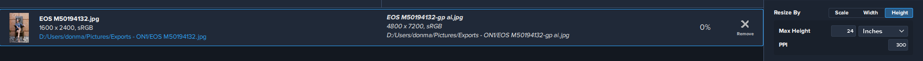

In the top right box, with the sizes, click on manual, then choose 300 dpi.
Choose resize by width or height and then choose the dimensions (inches or centimeters) then add the DPI:
Thanks for providing the specifics. I was going from memory, as my beast is in the shop.
