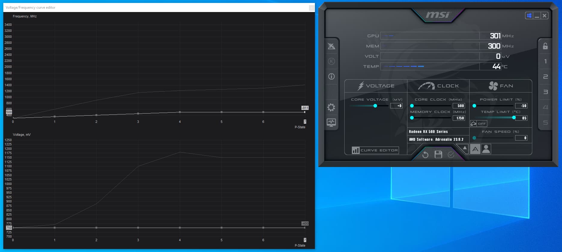

Hi everyone. I’ve found the solution for this blank / restarting / crash when processing.
I try to underclock to the VERY MINIMAL core clock (550mhz), memory clock to 1750, set voltage to 750mv on all p-states, and set power limit to -50% (some brand don’t allow it to this value, no problem just set to the allowed lowest value ).
It’s run stable without crash / restarting anymore. But its still cause some minor artifact / glitch on screen sometimes (maybe more underclocking again could fix this ?).
On the other hand, this could be very performance hit. More than 50% reduction on your GPU performance!!
But, I though it’s fair enough for aged GPU :grinning:
Check this screenshoot for more detail configuration ibb[dot]co/wSxMkBY
