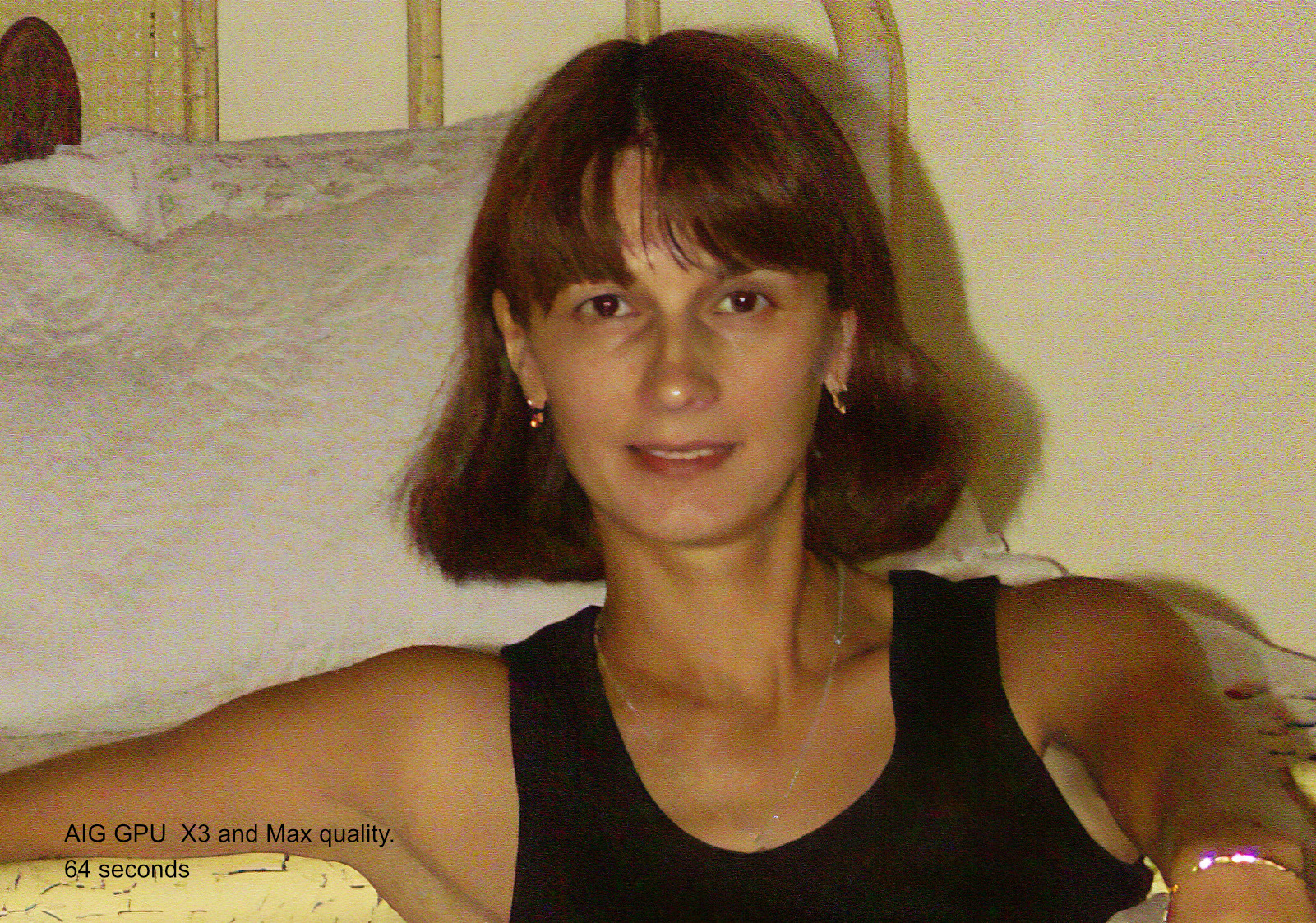

I just ran a test using a 10 Mpx photo and setting Gigapixel to three settings. The file is 1920 x 2560 and I enlarged it 300%. All cases used reduce noise = medium and Reduce blur = low. Using latest version as of 4-16-2019. GPU is Radeon RX580 with 4GB VRAM. Samples are crops at about 82% enlargement.

Setting Preference to GPU and Max Quality = yes took 64 sec. Quality was bad with a visible pattern over whole image. I would not use this setting.
Using AI Clear removes remaining noise but takes extra step.
Clearly using the CPU (Mine is a Ryzen 5 2600X running at over 4 GHz) takes too long with only a minor improvement. Max Quality GPU has a pattern issue.
