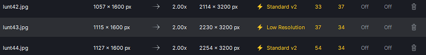

I have been playing with swithcing on the “AI MODEL” but when I do that it selects “Low Resolution” by defulat and I am unable to select a different AI Model.

I usually find it’s a good idea to try all the models with a source image that is in any way challenging… I miss the 2x2 grid view…
