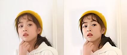

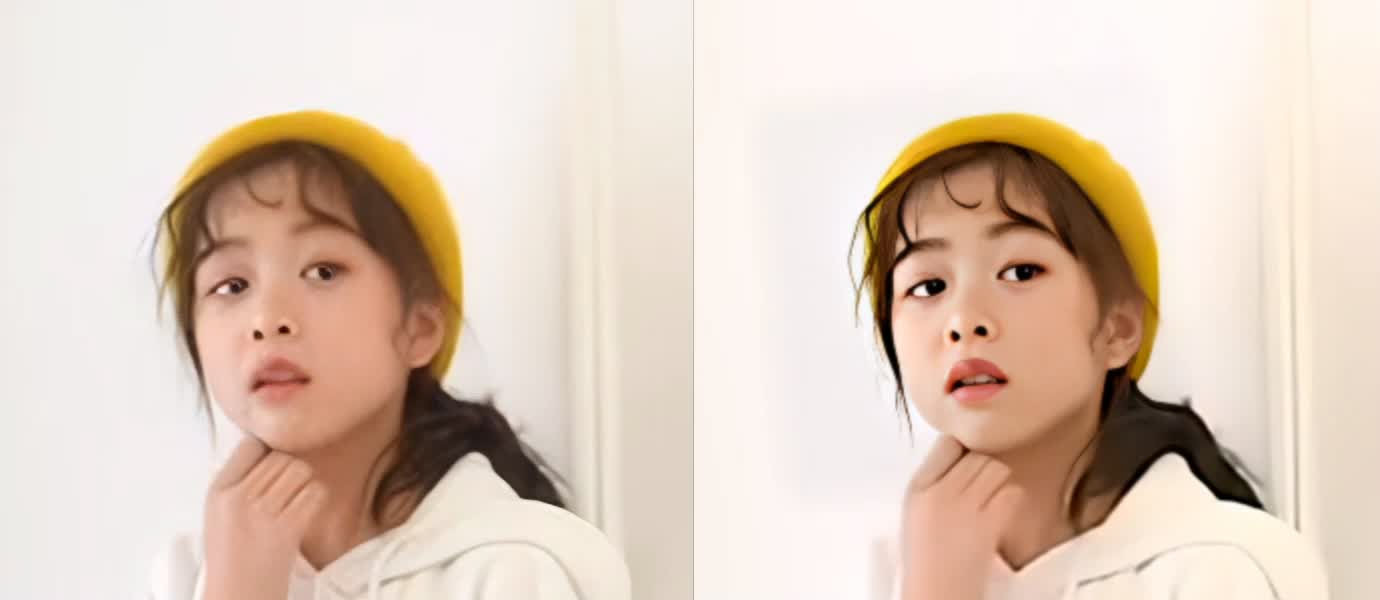

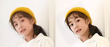

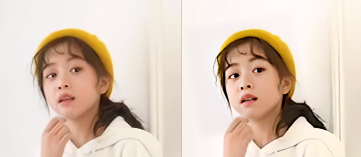

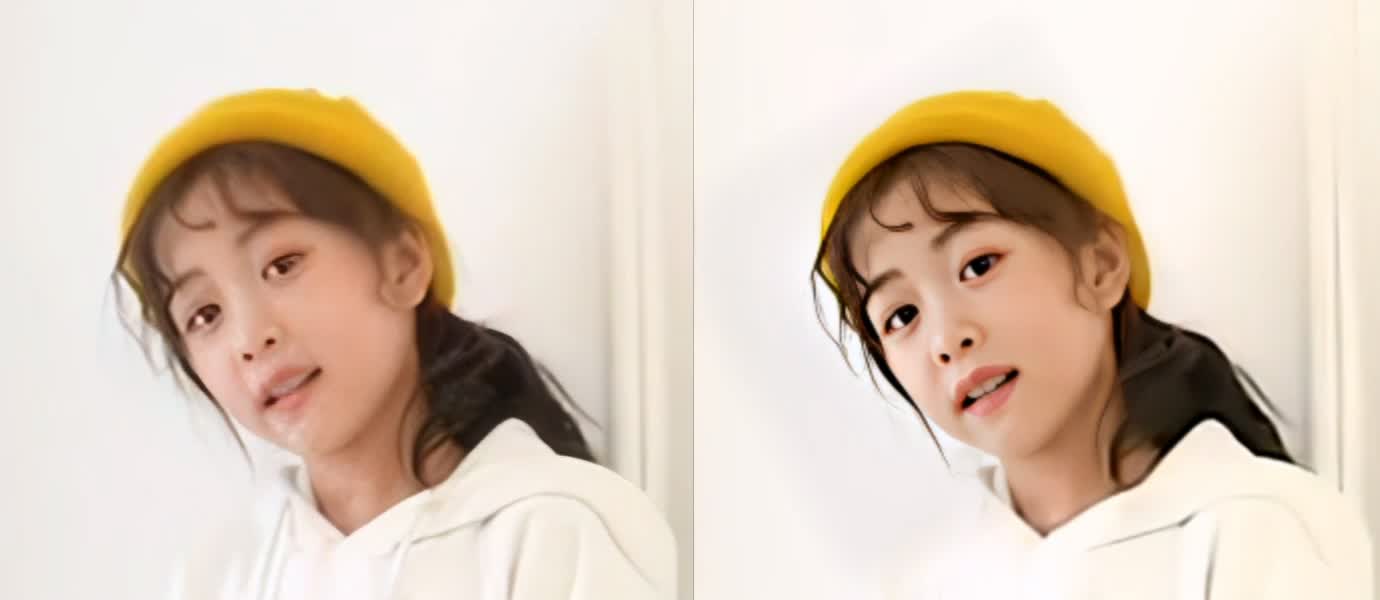

I have just tried a quick test on a very low resolution face to see how it perform.
Left is 4x on VEAI prob, Right is 4x on AVCLab (face refinement enabled).
The face refinement seem did a pretty good job on this low resolution example, it reconstruct detail on eyes & teeth. :100: However, other than the face, I still think VEAI is doing a better job overall. AVCLab tends to over-sharpening the edge and remove too many fine detail. :sweat_smile:
I am looking forward for VEAI to include face enhancement model in the software. :crossed_fingers:
