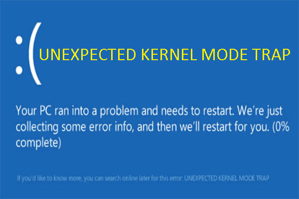

The codes I am getting are:
UNEXPECTED_KERNEL_MODE_TRAP
PAGE_FAULT_IN_NONPAGED_AREA
IRQL_NOT_LESS_OR_EQUAL
All caused by ntoskrnl.exe
this sounds like a Hardware issue (or Driver), not an application. it is the OS kernel which is way below the application layer does not even have access to. IRQL_NOT_LESS_OR_EQUAL is usually memory bus, Storage bus/chipset or CPU (or faulty Driver) and in some cases HDD bus.
Take a look at this list of how to resolve the Kernel Mode trap BSOD:
Thank you so much for the help. I replaced my RAM sticks and that seemed to do the trick. Unfortunately, for one particular video I keep getting an Error when it finishes rendering. If possible, could you take a look at my logs and let me know what do you think is the issue please?

Hi! After using the new RAM it would crash sometimes as well (less times, but still)
I ended up doing this for my BIOS and it stabilized:
you choose solution a or b?
i mean you just do the "Troubleshooting Update" in the last part of the article ?
Gigabyte: A, it ended at something like +0.025 I think.
