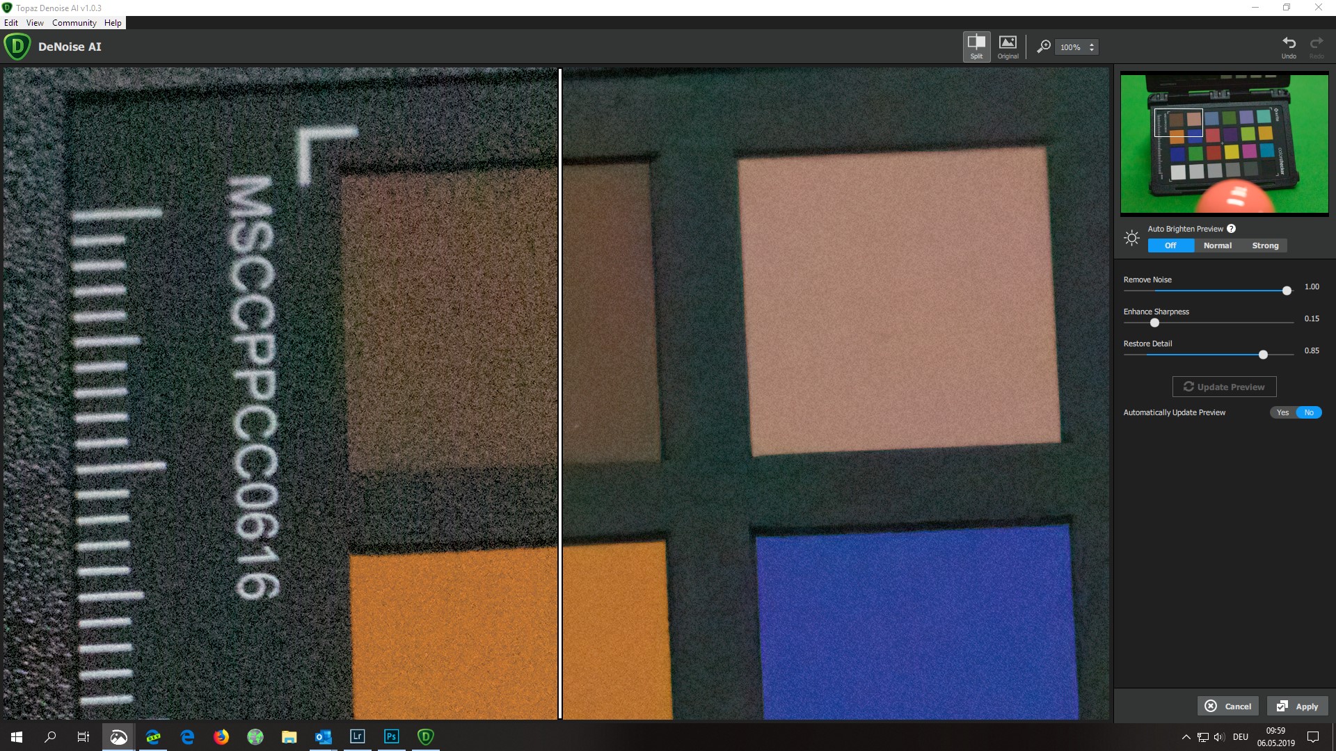

AIDN seems to struggle with images that have high color noise. It’s not clear if certain Raw files are affected more than others; I haven’t tested that. Perhaps it’s not trained for that, yet.

I also have problems with bad color noise removal with DeNoise AI. My workaround is the use of Lightroom or Photoshop to remove only the color noise and use DeNoise AI only for the luminescence noise removal. This work ok, but In future the color noise removal should be part of DeNoise too.
In my opinion the color remove is too limited and worse than Lightrooms color remove.

At ISO 100K, DeNoise AI is without help from Lightroom useless.
DeNoise AI alone on my filtering
With Lightroom color removal, again the filtering could be lowered only this high for comparsion

Just attempted to use Denoise AI on a very noisy image and it did little if anything for the color noise. Had to run it through Denoise 6 to use Clean Colors slider to fix.
