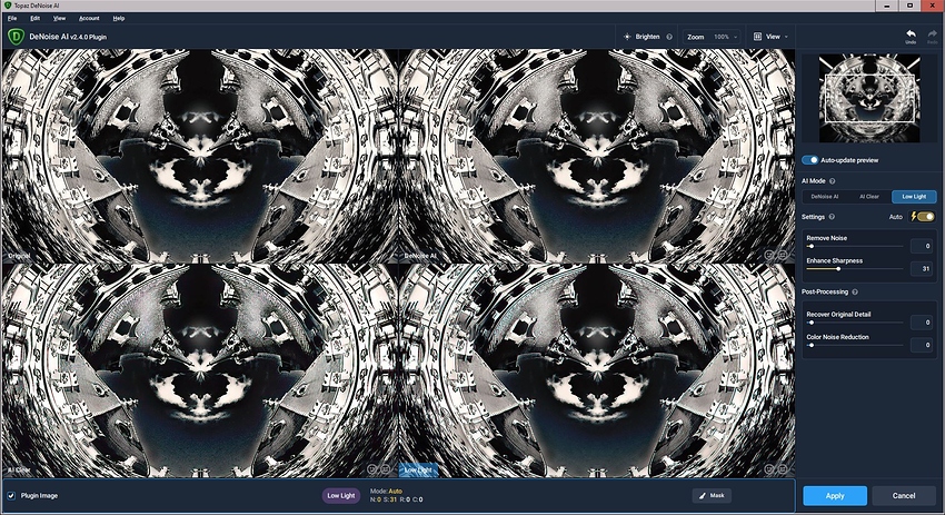

  • Uninstalled previous rel. & beta release. Installed this commercial rel. to Win 10 Pro PC - to be used as Ps 2021 plugin. Ran “calibrate” on the standalone then closed it.
@amy.mae
  • For image (processed using my Ps DAI plugin) below AIC and LL modes produced a green/cyan color tinge using Auto Settings. Didn’t see the color tinge on DAI mode. At least not as noticeably.
p.s. I only processed out the DAI mode option back to Ps 2021 b/c it was the only one that appeared acceptable in the DAI 2.4.0 interface. In “real life” I wouldn’t process options that intro random, unwanted colors.
