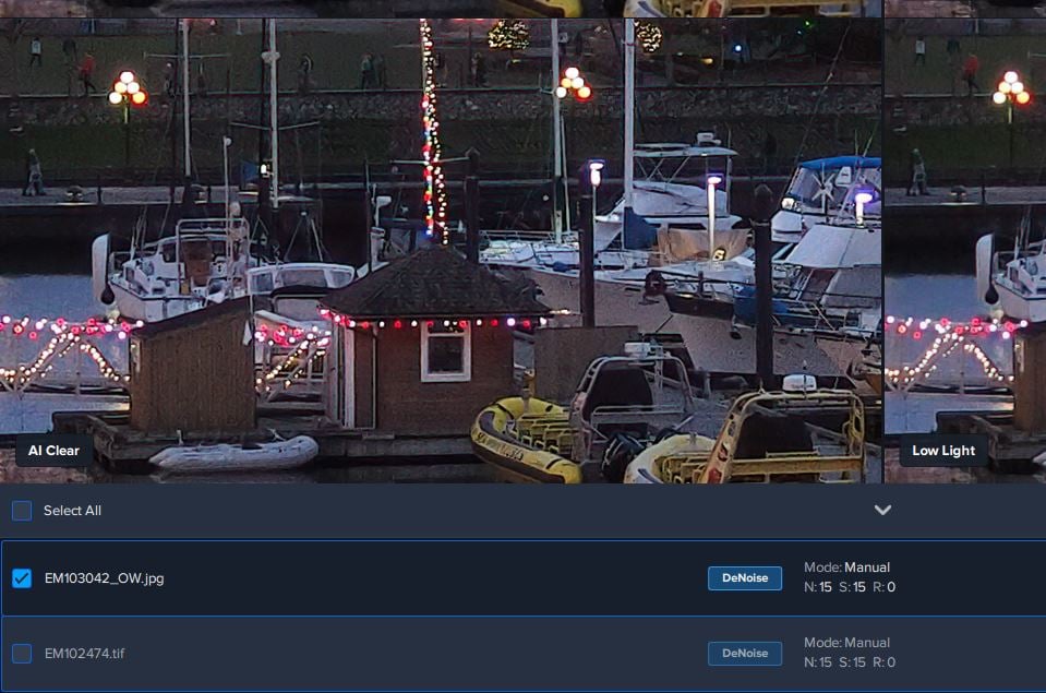

Adam, perhaps you know already, but I just noticed a small bug with 2.3.3. When you have a file opened, and open another one, the new image appears, but the focus in the file list at the bottom of the screen stays with the previous file. See image below; the image that is shown is the newly opened TIF file, the focus is on the JPEG that was previously loaded.
I compared against Sharpen AI, and Sharpen AI has the correct behaviour.

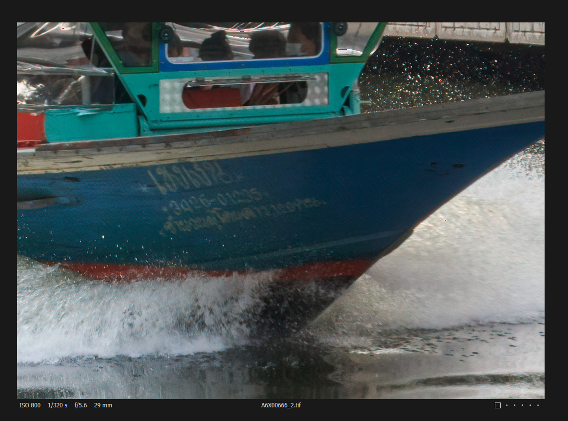

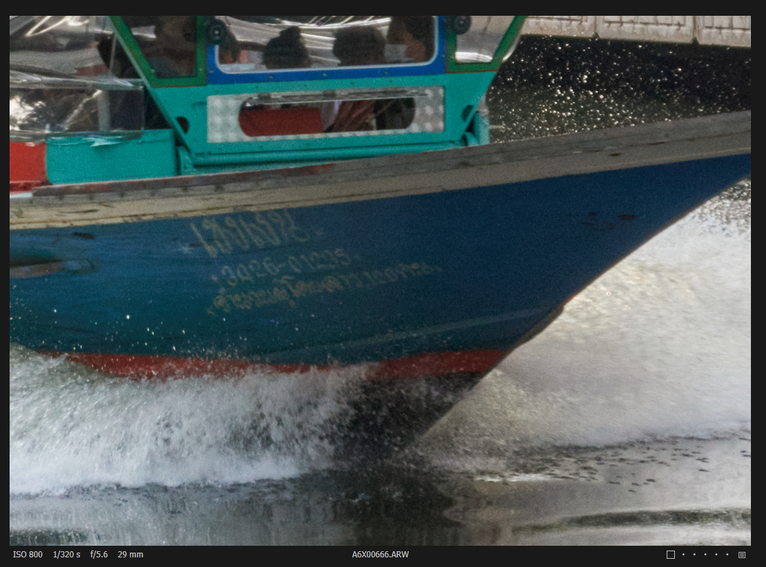

It seems that Low Light mode is producing patchy results, especially notice that Noise is removed at the bow of the boat but where the name is (lighter color) it isnât removed:
BEFORE
AFTER where you can see the distinctive line where the noise reduction has changed just before the writing on the 3rd line ends.
I often observed the same in the previous versions of DNAI which did not have âlow lightâ, in both GPU and CPU modes. Iâd say, it consistently appeared around the borders of a sharp light object and darker unfocused background.
I changed some things in the file list for 2.3.4, so let me know if this is still the case. Thanks!

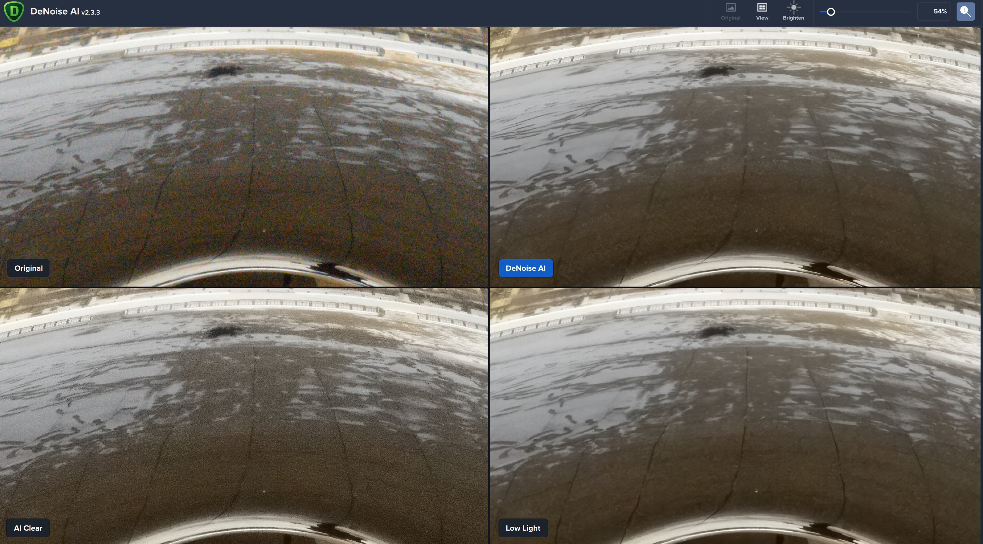

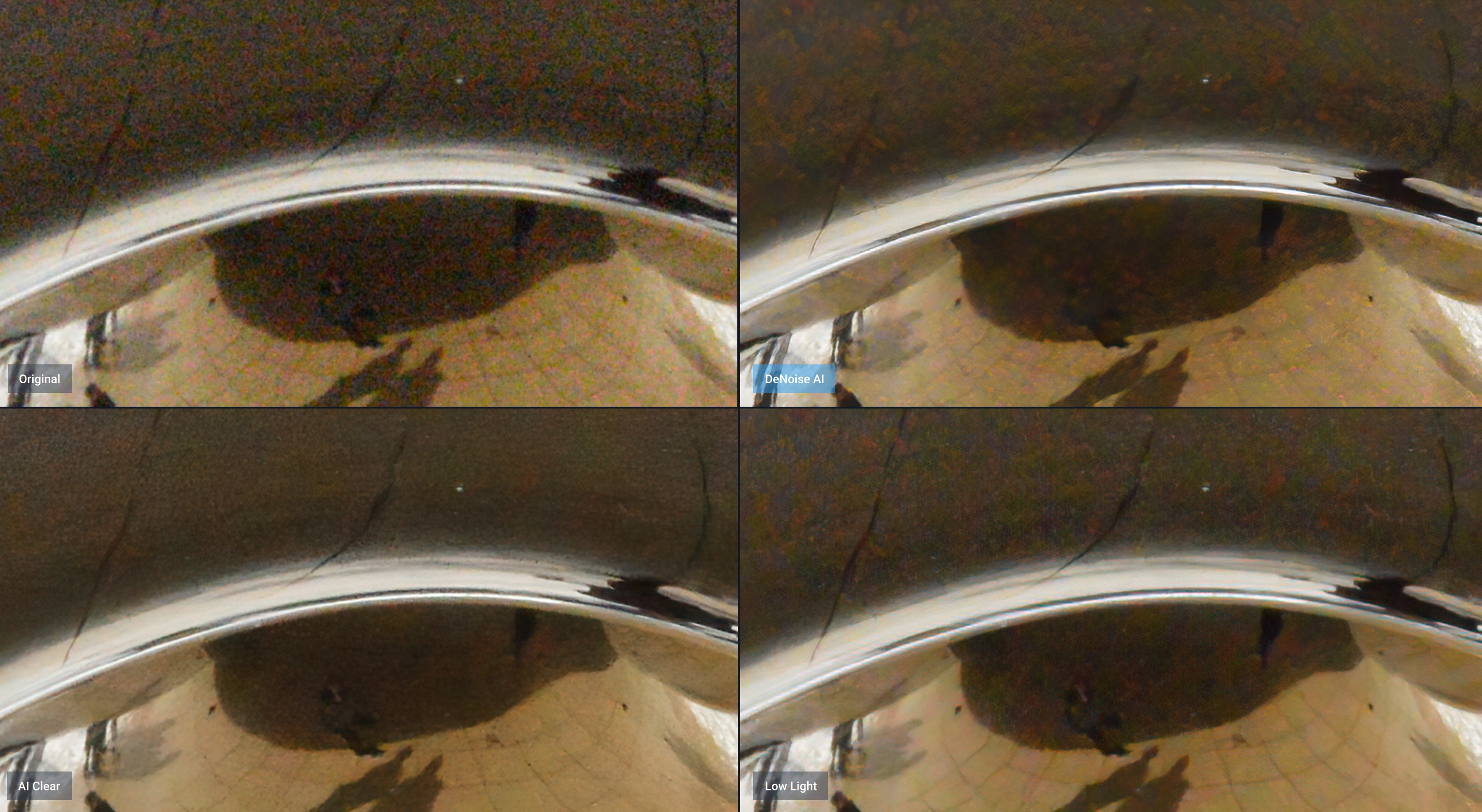

Denoise AI 2.3.4 doesnât seem to be doing as good of job on color noise as in the past. With settings maxed out I still see a lot of color variation. Clear is doing a better job. I had no issues cleaning the image up in Denoise 6.

I tried it again. When loading a new file, the highlighted file in the file list is the file displayed, which is correct. However, the focus remains on the previously loaded file. The expectation is that the focus would switch to the newly loaded file perhaps?

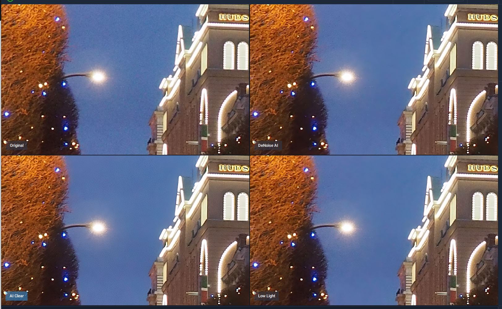

This is similar to the behaviour observed in this image near the bright light, but isnât new. I always assumed is was because of the noise variability in the original image near areas of high contrast:
The AI does think that the noise is detail that it should keep.
