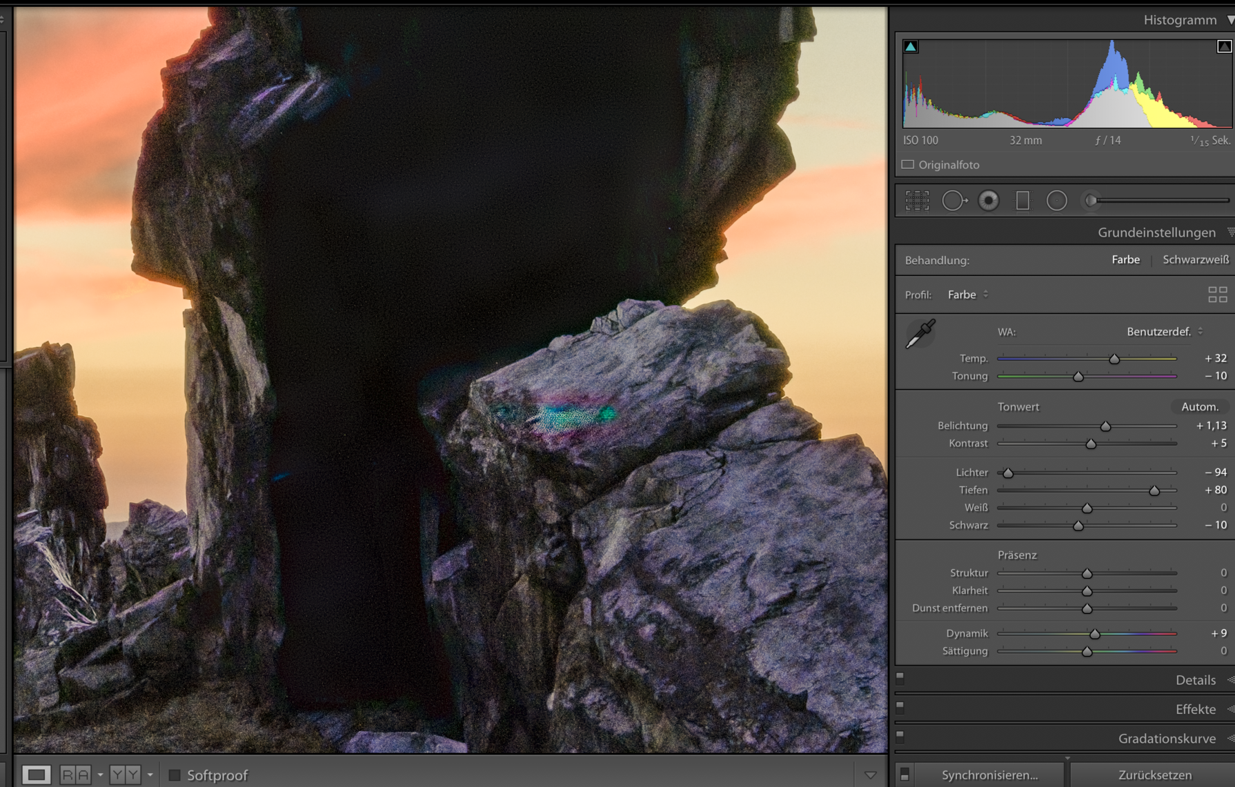

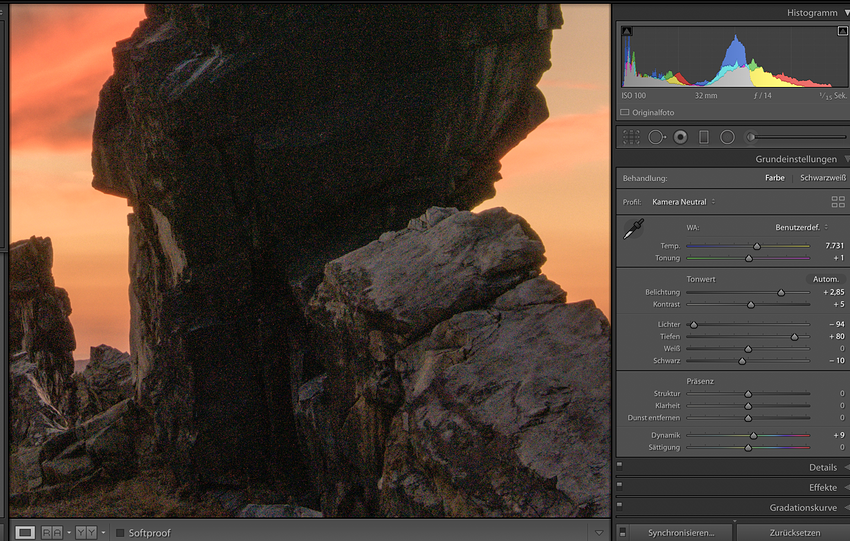

  3. Please see the two examples below. Guess which one is the original and which one is processed by DeNoise 2.2.3? The DeNoise is done with auto setting and recover detail (20%) and 0,1 Color Noise Reduction. It looks really ugly with the heavy green and red artefacts. (I also used brighten which seems to be saved as well).

  3. That’s a Nikon NEF from D850 (ISO100). That’s what I thought, it’s just for better viewing but It definately saved the the brightened image. You can also see it according to the LR values. It became around 2-3 EV brighter and quality looks very strange. I did the DNG straight from the NEF as standalone. In LR both have the same develop settings.

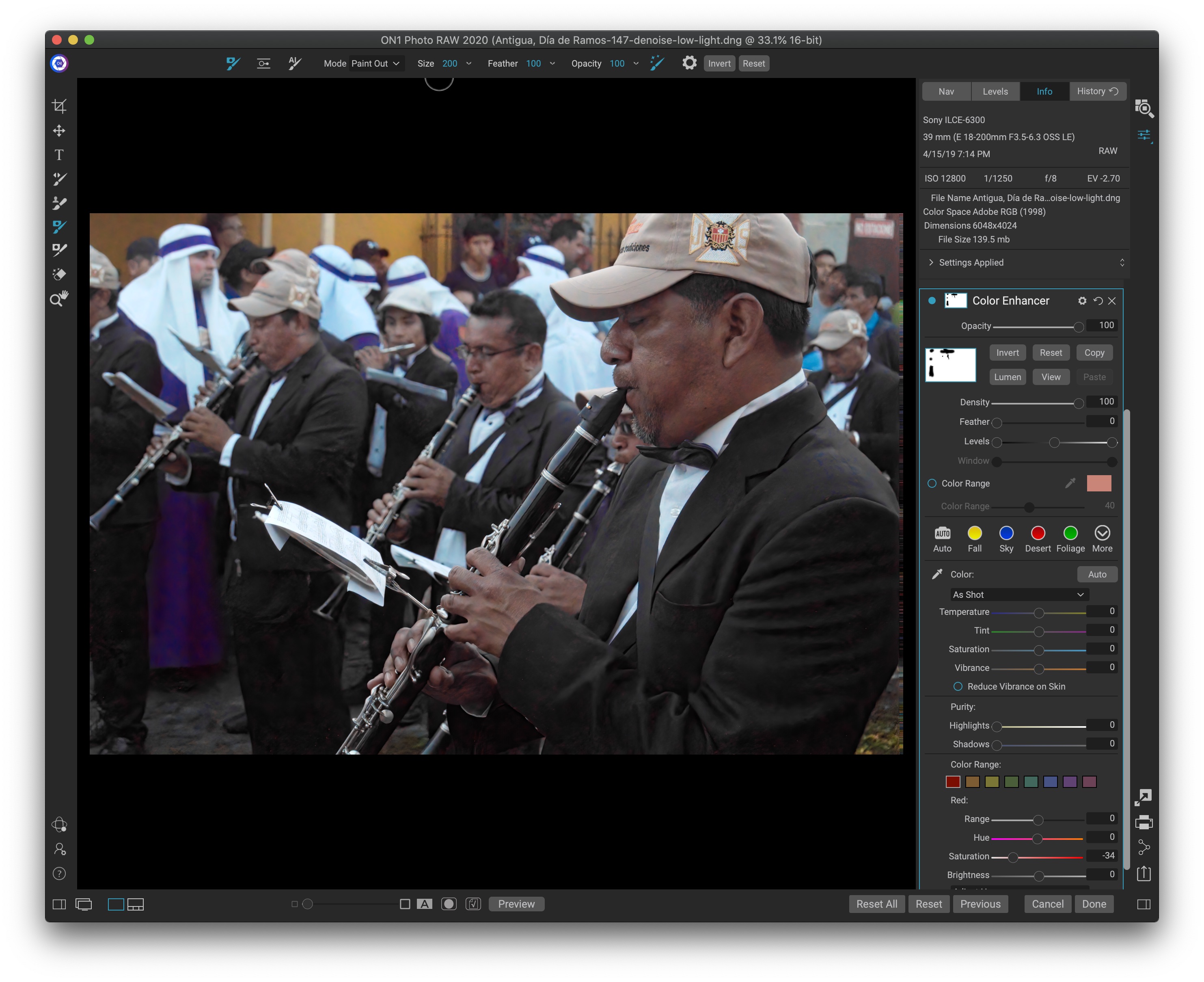

With the release of v2.2.3, I am no longer having an issue with Low Light Mode. I have tried it on a few photos and it all seems to be working. However, I seem to get a better result using DeNoise AI as a standalone and working with the original DNG than I do sending a TIFF or JPG copy, with minimal editing, from On1 Photo Raw. In order to obtain something approaching true black, I do need to use On1’s Colour Enhancer to reduce saturation in the magenta and purple channels.

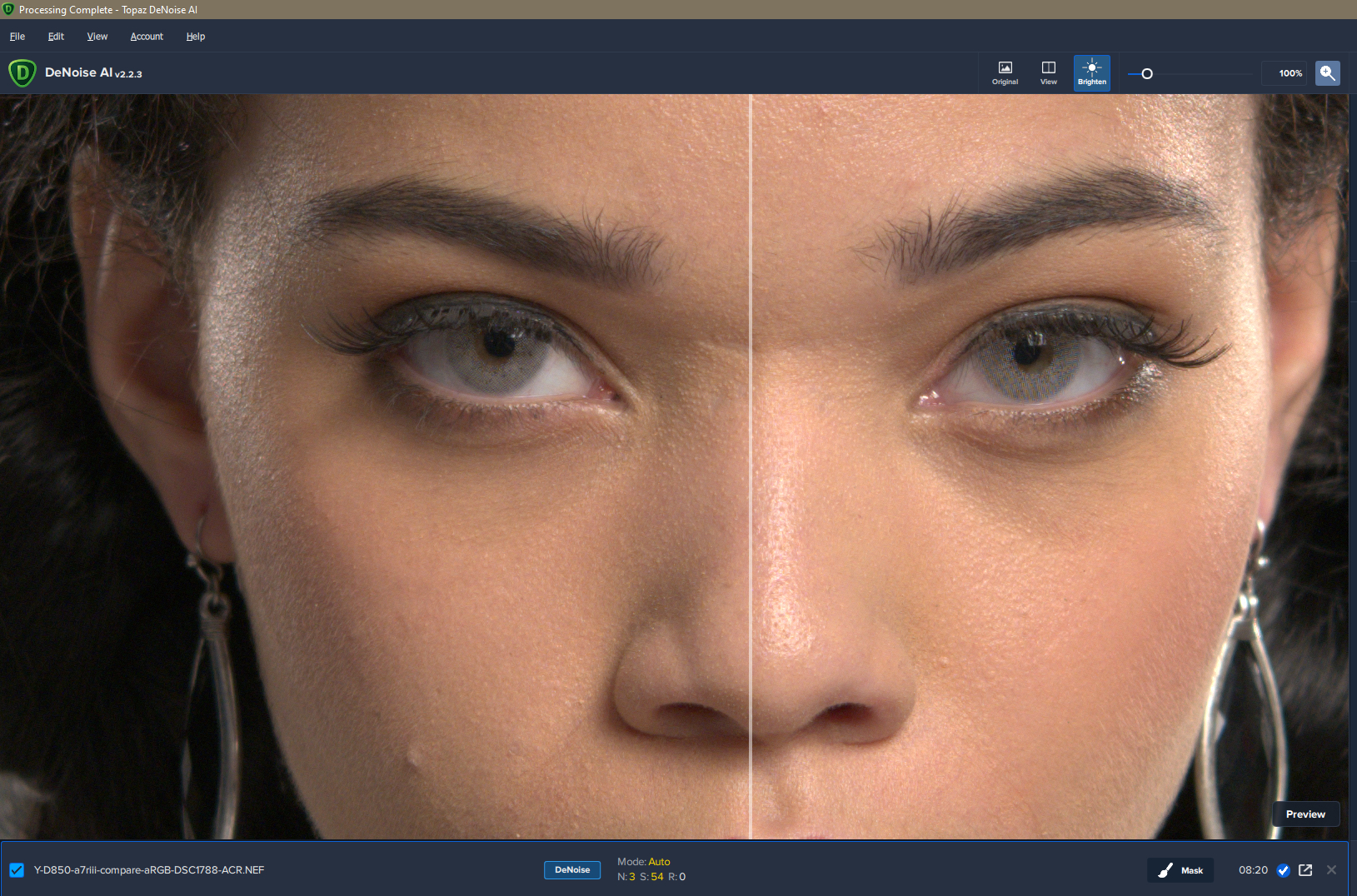

I believe this is an issue with the DNG & Profile written from DeNoise and other Topaz apps, long ago I stopped using DNGs as the output was inconsistent. In this case you can see a D850/ISO250 image as the input to DeNoise where brightness is set to ON, and the second image is the TIF output but no brightness:
Output TIF, 16bit, no compressions, ProPhotoRGB
My advice is do not use DNG output because it is, I believe, exactly the same as TIF except in a wrapper with a profile that doesn’t work everywhere else.
And I you want to check the sizes … the DNG is way bigger than a DNG generated from the original and is exactly the same size as a TIF.
