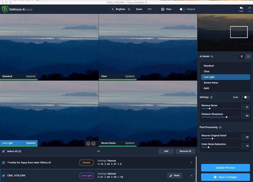

Downloaded DAI 3.3.3, no problem. However, there isa strange happening with Clear on this dark, grainy CRW
image I have been using as one of my test images. I think I have seen this before but this is the first time with 3.xx. Note also that the severe noise image is much softer than the standard or lowlight. This is not new. Also, I would like to be able to intall upgrades without overwriting the last version, is this possible? I now can’t compare without reinstalling from file…

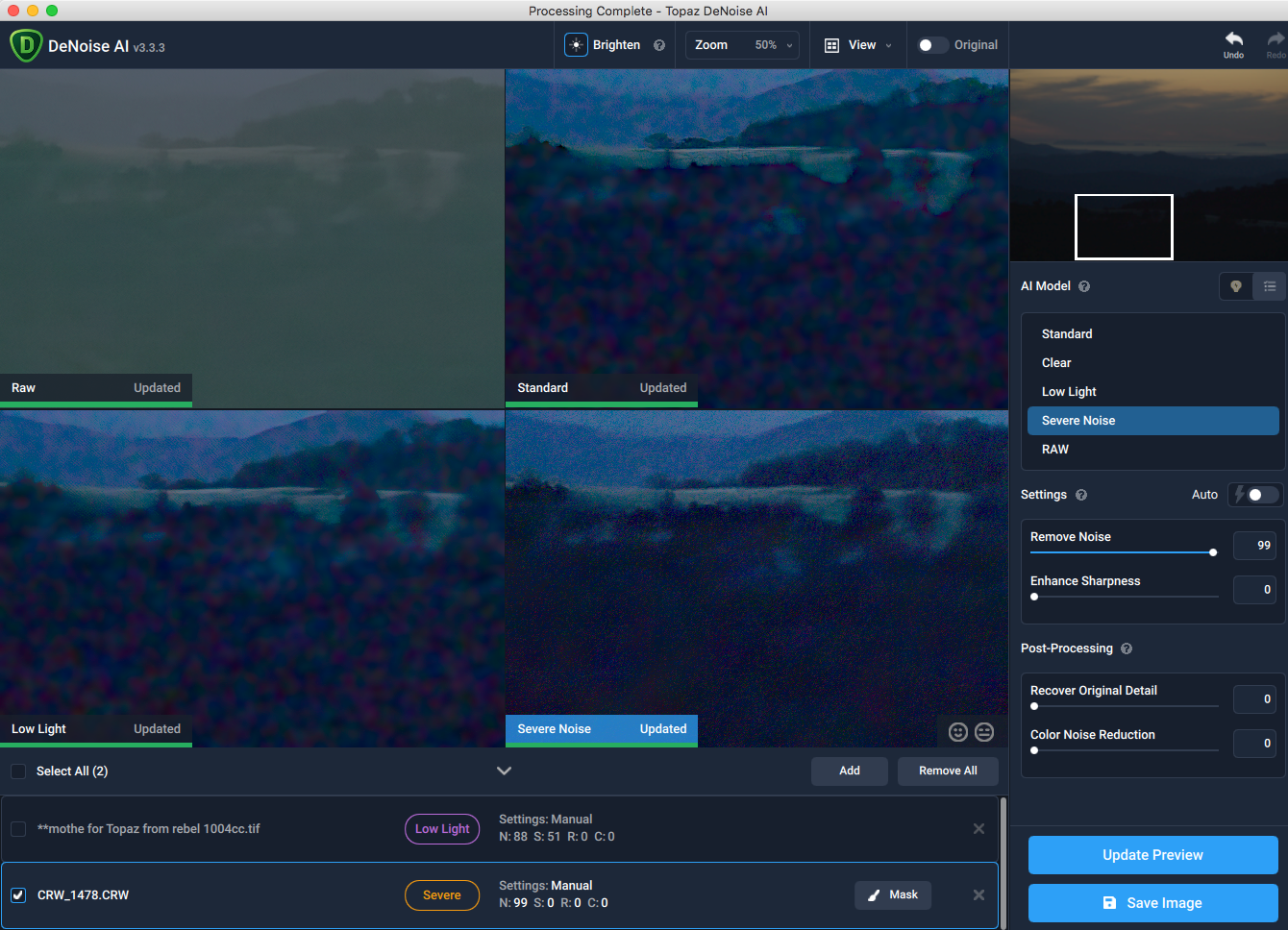

The good and bad news: using RAW (with the CRW file) in DAI gives a very flat image as you can see, but, the other choices produce color bobs in the low light sections, Clear is extremely bad in the shadows. Severe noise actually increases the noise or so it appears. No sharpness was applied.
