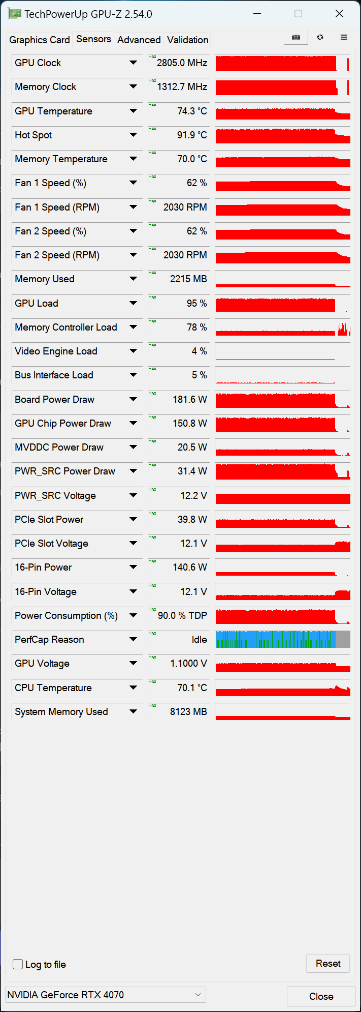

Hi again, here’s an outtake (removed processing rows in the middle) from log 2023-08-06-15-51-35-Main.tzlog - the last failing MP4 process- Part 1:

DxDiag.txt (94 KB)
GPU-Z Sensor Log.txt (7.13 KB)
logsForSupport.tar.gz (119 KB)
WEH.txt (4.75 KB)
I repeated that same process once more, and also the result was repeated. I come to think, could it be that Topaz is working so hard and not tolerating any kind of system interrupts? After that second crash the system had suffered unrepairable consequences, so it had to be rolled back - with Macrium Reflect.
If this isn’t fixed within the 30 days refund guarantee, then I want to use that alternative. /jb
Obs! SPAM-mappen kollas inte längre! Saknas svar, mejla då igen (från annan adress!).

Thank you for your thorough with your testing. No we do not have any known issues with the 4000 drivers, however, I do see the crash occuring. I am going to have our developemnet team take a closer look.
Right now my best guess would be thet your machine may be having a cooling issue or your power supply may not be great enough for the device.
Hi,
No, no, I have very good cooling for both CPU and GPU, no component is nowhere near getting hot.

Hi again,
Just to prove my point I moved the RTX3080 (very power hungry compared to the RTX4070;) to the first computer (the one it all started with - with the RTX4070), and processed the longer source file. It maxed out with 461W (computer alone) and managed to process the file without any problem (attached DxDiag, RTX3080.gif and RTX4070.gif (see difference in BPD!) plus again a logsForSupport.tar.gz). /JB

Hi again,
And regarding the PSU, it has no problem running even heavier loads.

Hi,

| ida.topazlabs Product Specialist
August 9 |
