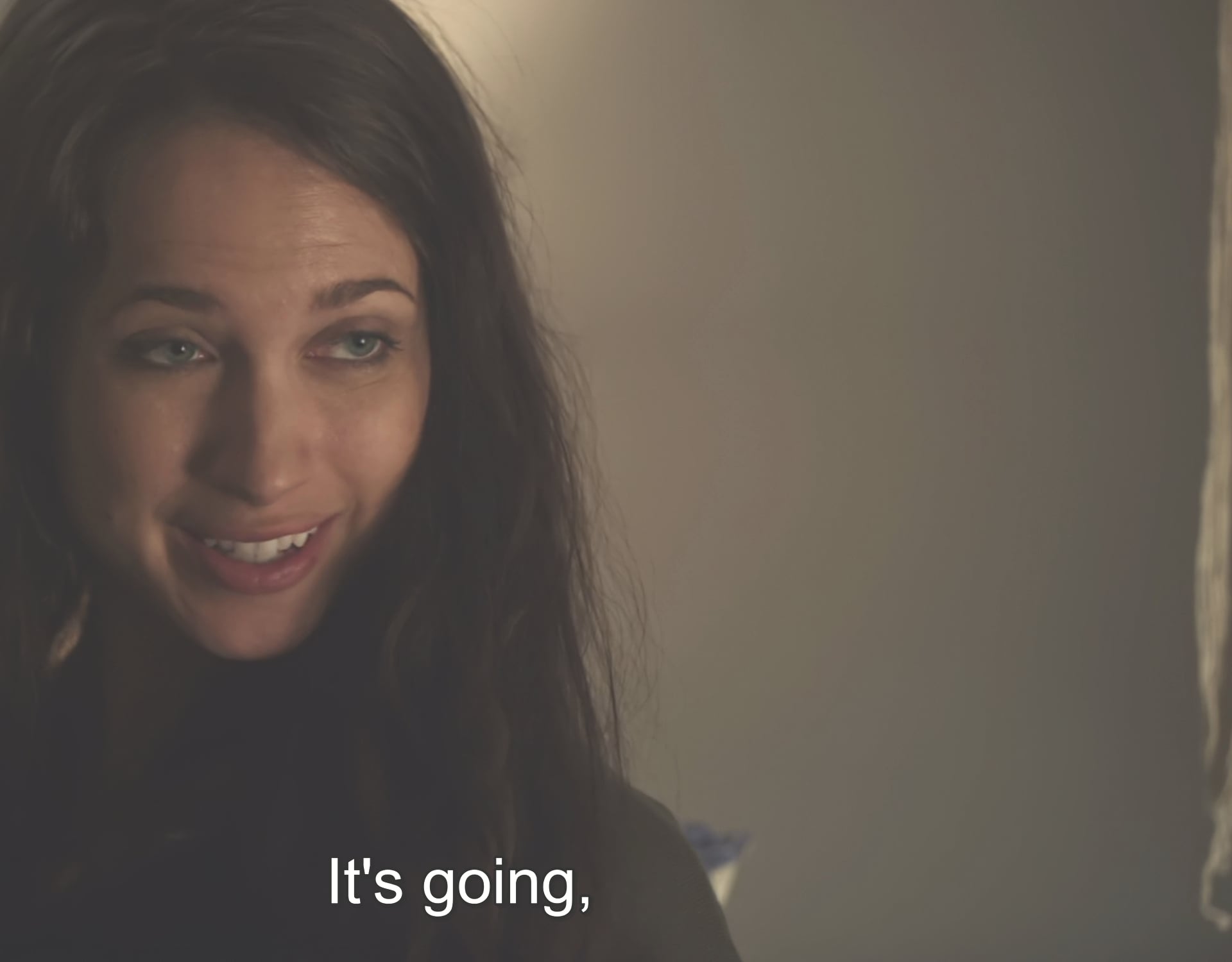

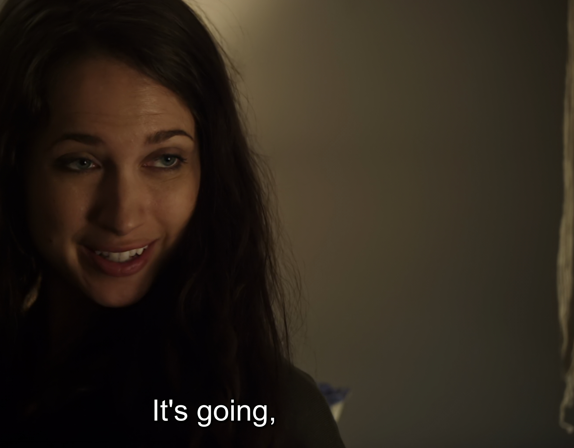

here

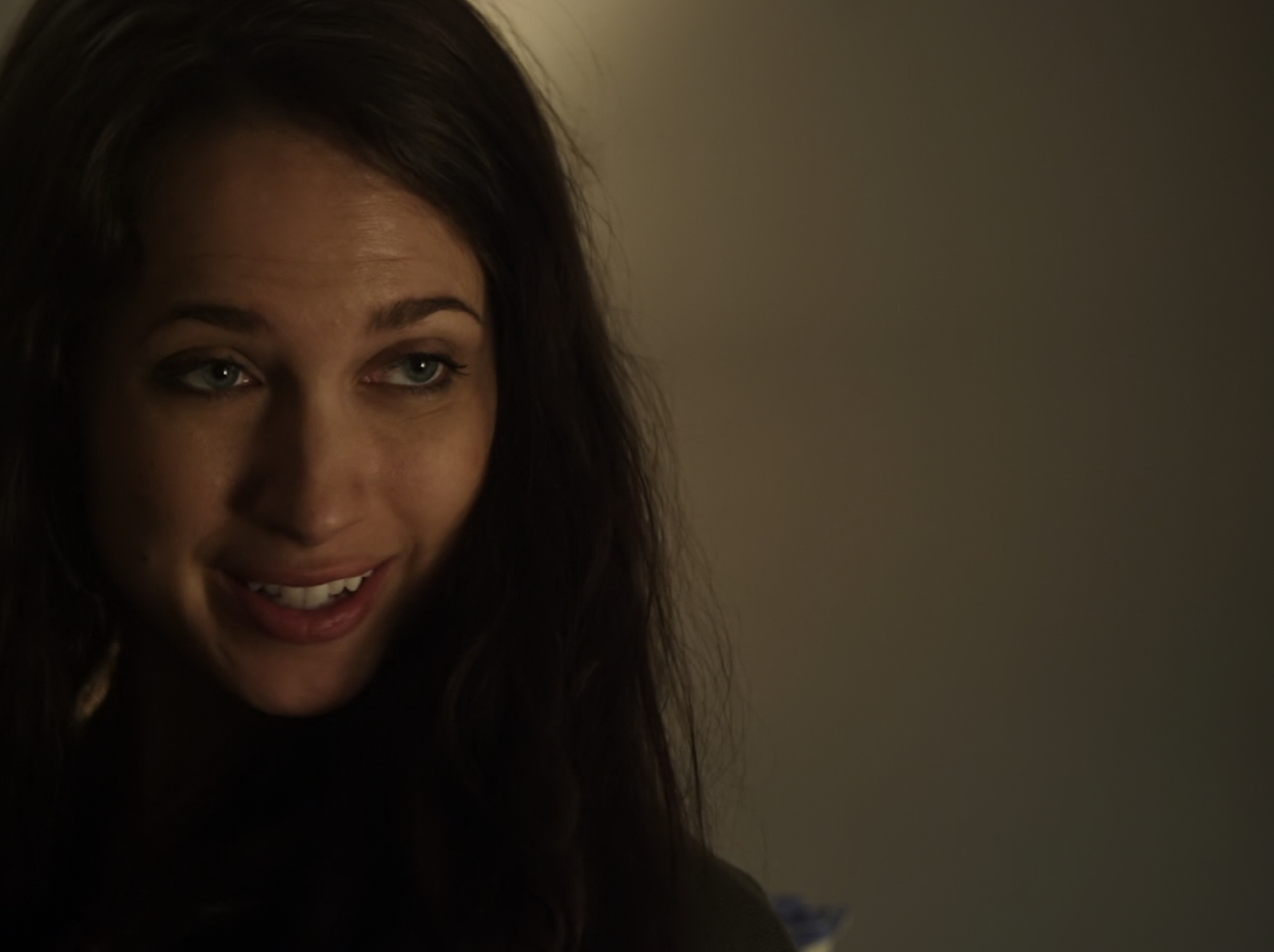

How about the nearest frame from the source too?
No banding original

Do you still see banding in this version of your image with a linear brightness adjustment (don’t rely on viewing in the browser)?
Yes and the image is blown out.
I think most of the banding you’re seeing is related to the limits of viewing video with subtle 8-bit gradients (especially if also viewed on an 8-bit display). The original is probably less affected (but it still is) because of mild noise/dither patterning. It’s on a visual knife-edge.
I know you said you’re not interested in using grain to fix an issue like this, but I don’t think you have many options when working with 8-bit sources. You could try Proteus with tweaked settings to reduce the effects of compression. But you would have to use a 10-bit or better codec for the output, and this wouldn’t be much help when viewing on an 8-bit display.

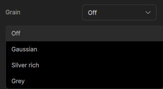

Adding a slight grain with the new grain tool gives some better options and variance that can be tried to help with the lower bit sources and viewing. Understand the desire to not apply it but as Alan mentioned it might be the best option here within the current workflow you are running.
