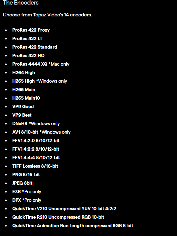

But which video fileformat is able to hold 16bit?
And which models are generative?
I know only the compressed ones.
With the extra Colour information if you Downgrade to 10 bit H.265 with or without Dithering should give you the best Colour transition
Alternatively Downgrade to 8 bit H.264 with Dithering for hopefully similar results
All of the models generate new pixels when running as needed, but the true “generative-AI” models that will add new details and create them are within Astra under the creative settings right now.
The GAN-based models (Proteus, Rhea, Iris, etc.) and the diffusion-based Starlight family within Topaz Video desktop app will not creatively generate new pixels, they are working with what is already there and generating new pixels as needed to fill in when upscaling or enhancing/altering details based on the source video.
For 16-bit, you would need to swap to image sequence outputs and use EXR, TIFF or PNG formats.
