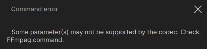

I cant export video to AV1 format, on Nvidia site it says: “All GeForce RTX 40 Series GPUs — including laptop GPUs and the recently launched GeForce RTX 4070”. On logs files I can see:
2025-09-06 13-22-48.370 Thread: 19120 Critical Error sending packet to decode Function not implemented
Your platform doesn’t support hardware accelerated AV1 decoding.
In settings I have set “Video Encoding GPU” to Nvidia, but it doesn’t change anything, any fix?
I was trying to export two different videos with no luck, one vid is AV1, one AVC. Screen shots of errors, video files info and support logs in attacheme. Is this software even working? (irony)

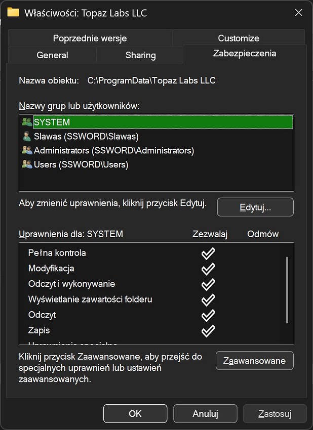

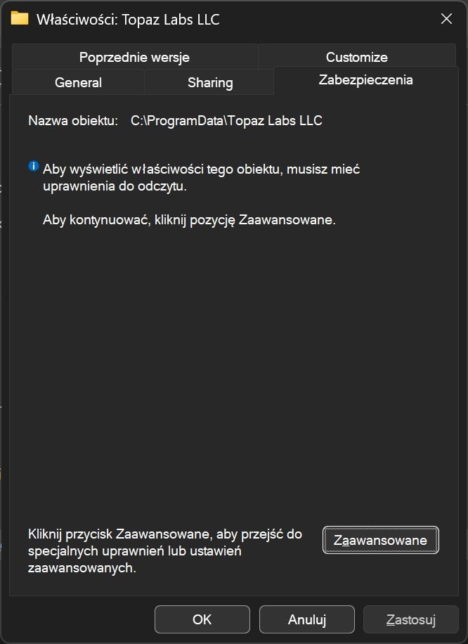

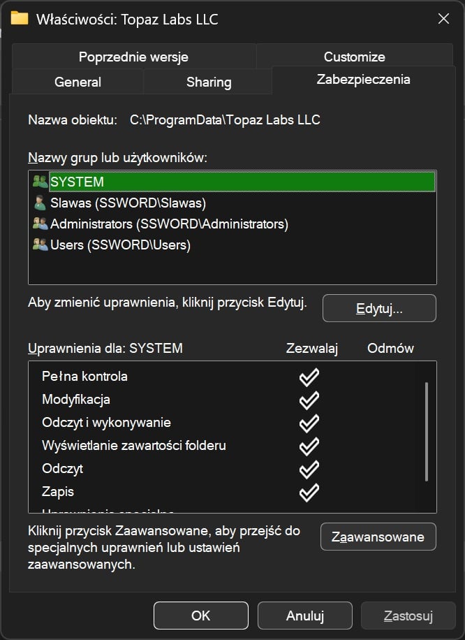

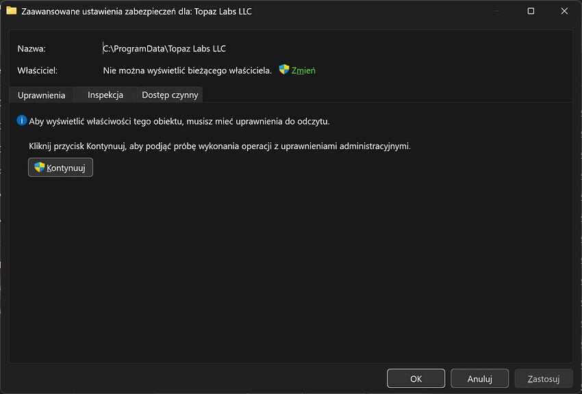

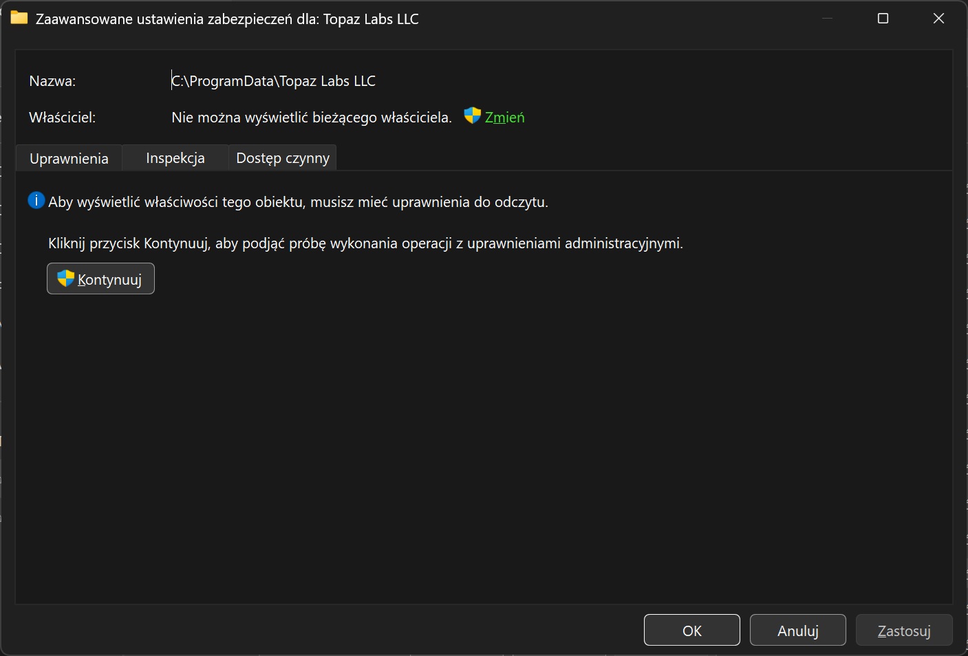

Ok, I found solution, the problem was with folder permissions C:\ProgramData\Topaz Labs LLC, this is how it looks before:
And this is how it looks after i made changes to folder permissions:
The program could not download any models because it did not have permissions for this folder, now everything is working fine.
