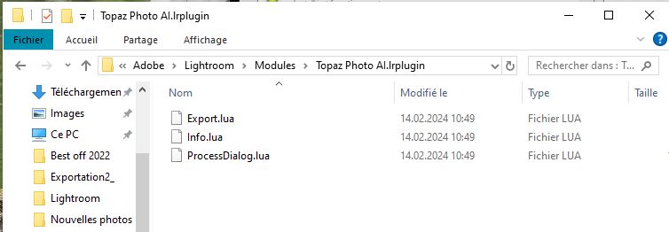

Here are the files in the Topaz Photo AI.Irplugin folder
Error 3
