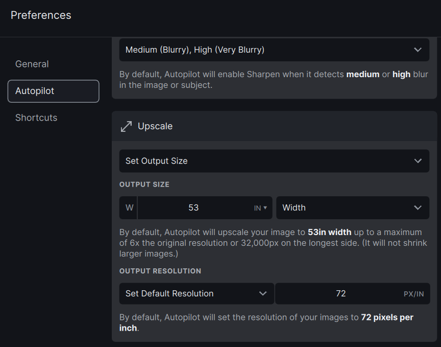

We are releasing a new version of Topaz Photo AI this Thursday which will have a global resolution control.
It will be accessible through the Preferences > Autopilot > Upscaling menu. Let me know if that is working well for your needs after the release on Thursday.
Hello Lingyu
It works but not totally. When I do "apply current settings to all " it’s ok, in the software, but once I save pictures there is one in 300 DPI and the others at 72 … :frowning:
Thanks for sharing this. I made a task for my team to fix the Apply Settings to All behavior with resolution.
For now, to set the resolution for all the images in a batch please use the Preferences > Autopilot > Upscaling menu for this.

I am interested in purchasing however I wanted to see if there was a way to set the px/in to 300 as shown in your screenshot. I am currently using the demo version and when I tried to follow your steps I don’t see the same options from your screenshot. Is this because i’m on the demo version?
Please follow the instructions in this video to set the PPI.
