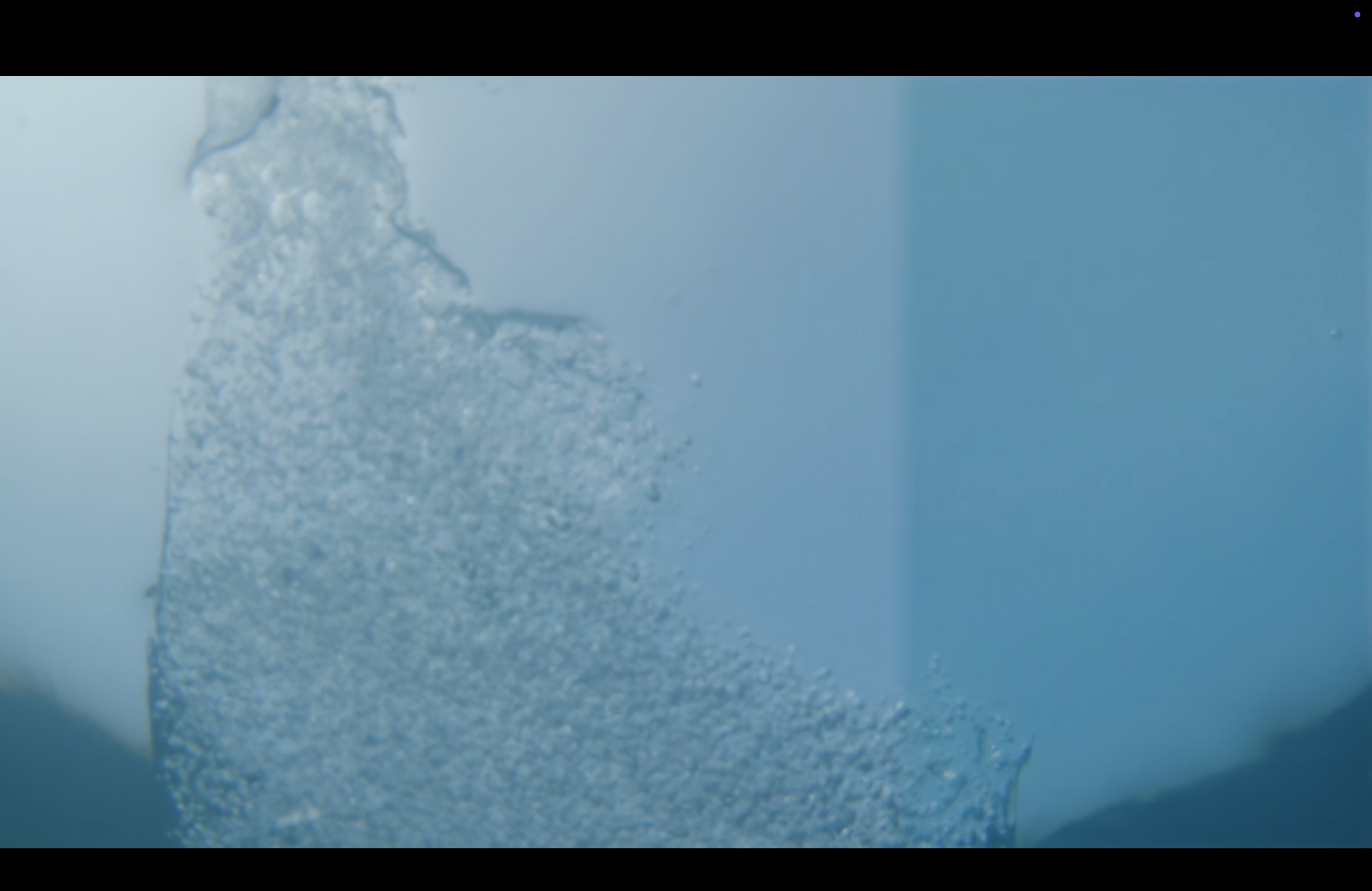

Aion Slow motion unexpected artefacts?
I tried to use Aion to slow motion footage… Slow motion is much better as in other models like Apollo or chronos… but there is flashing artefacts for some ms… in entire footage… I tried to generate multiple times it just not work…
Hw: AppleSilicon M3Max 64GB…
Slowmotion is well done but this artefacts flashing randomly make it unusable…
I have realy issue to find any working model without ranom artefacts…I have feeling ists not production ready…

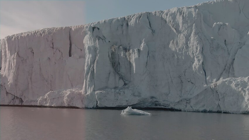

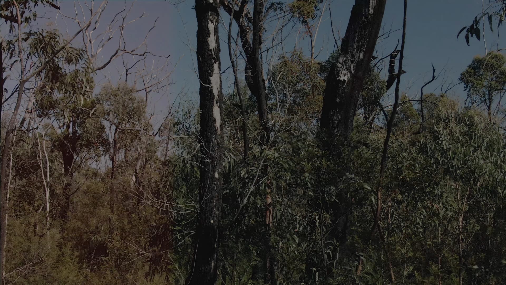

I’m getting exactly the same coloured banding.
I’m trying to use Aion to create some slow motion clips however they are all producing very pronounced vertical coloured banding across all footage.
I’ve tried:
Experimenting with different output speeds - from 4x-16x.
Completely different footage from difference source cameras
Different re enhancement models
I’m on a 2025 (2 month old) MacBook Pro M4 Max chip, 64gb ram and running Sequoia 15.6
