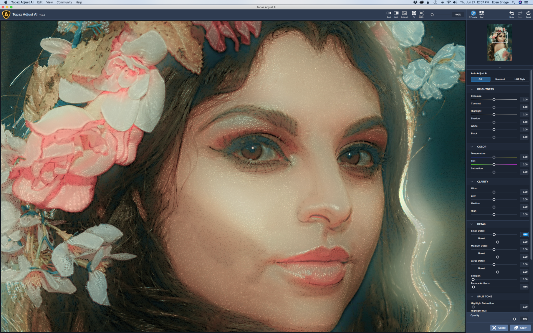

I have submitted a support ticket with all of the screen shots. But I really appreciate your concern. The first thing I did was create the support ticket. I am only sharing here for the benefits of the Topaz Community. I am sure that other Mac users are having this problem. I just came home from a private lesson in which my student is having the same issues that I am having and he also is using a Mac Pro with the latest Mojave update 10.14.5.

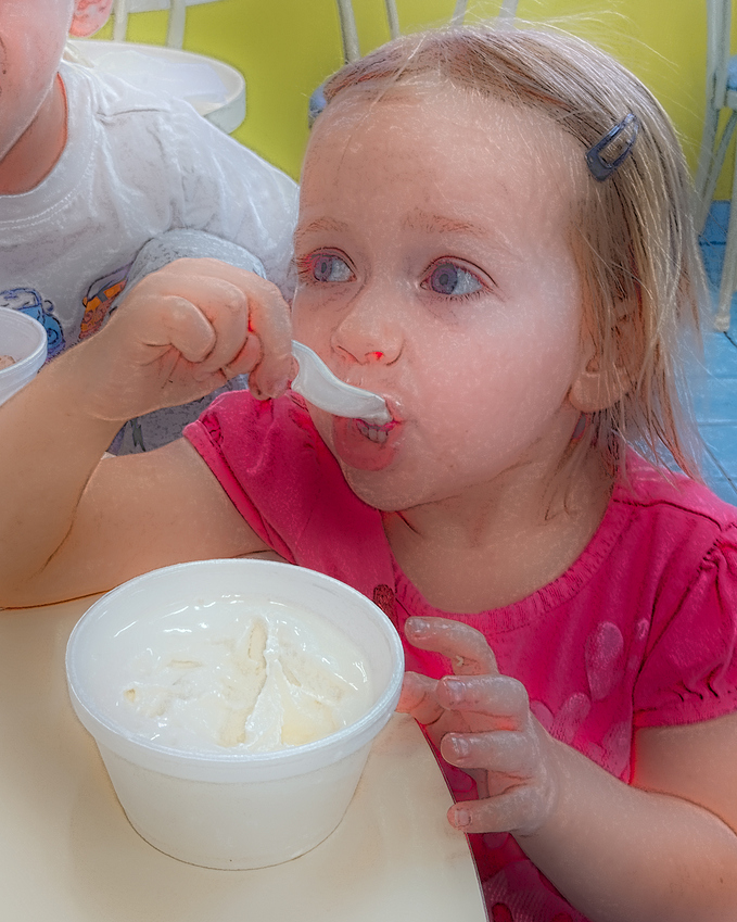

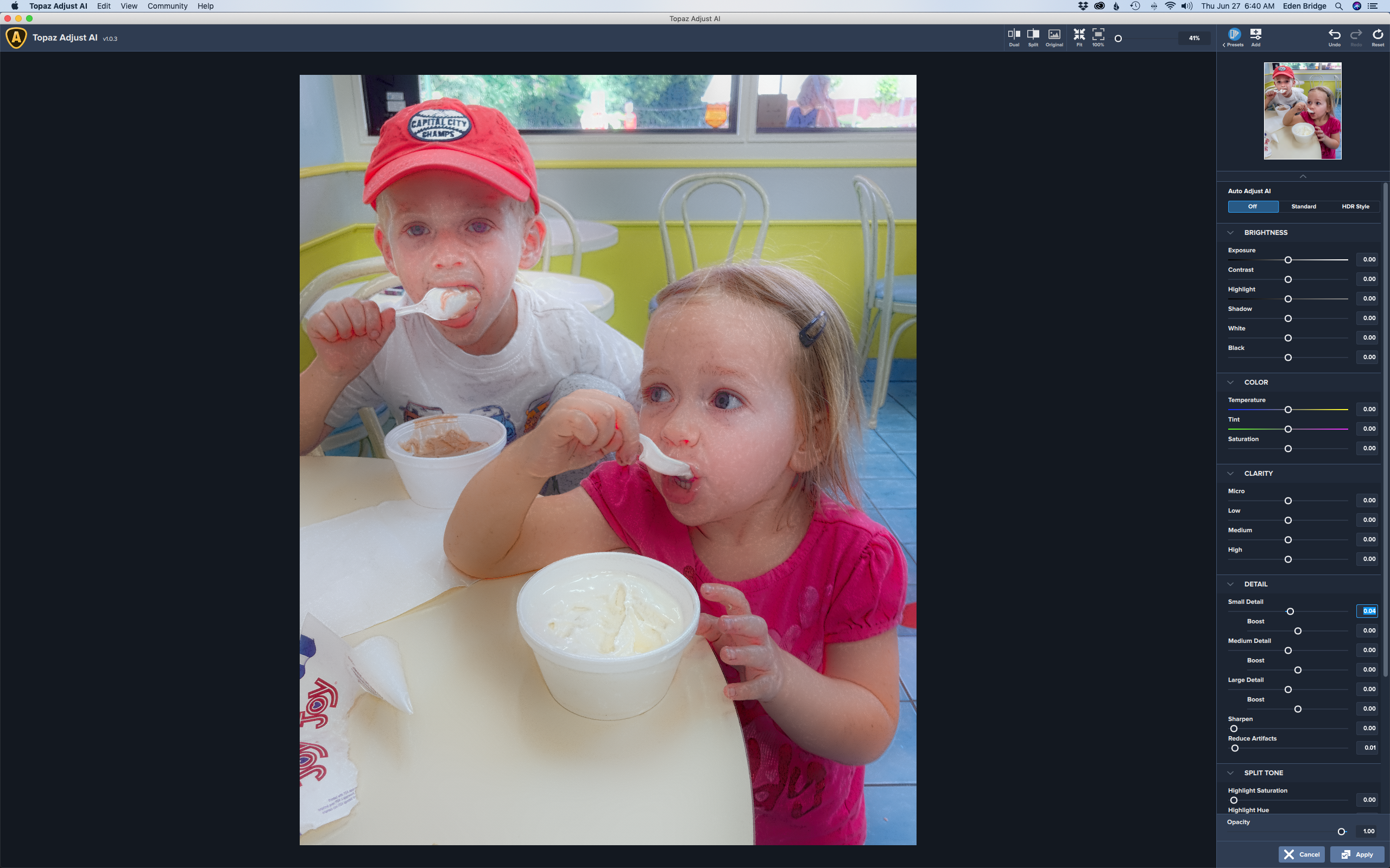

Fotomaker brought up the fact that I had the small detail slider adjusted to high so I wanted to show you the same image with the detail slider at a very low amount. As you can see this is not the proper behavior of the small detail slider. The first image is a screenshot so you can see the slider amounts and the second is a jpeg zoomed in so you can see the results and the third is the original with minor adjustments from DXO Photolab 2 with Prime noise reduction added.

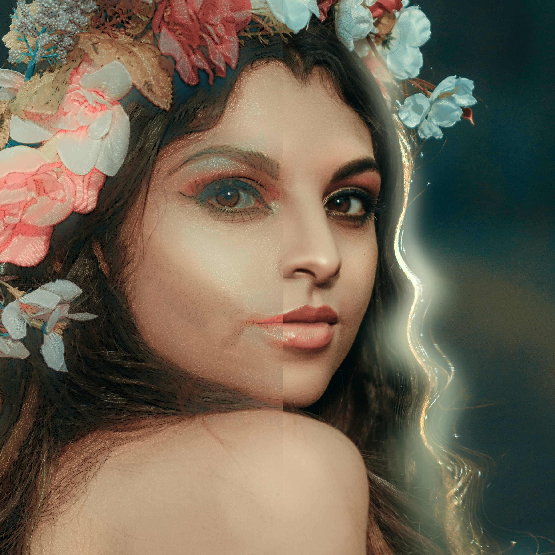

Using your jpg clean photo I opened it in Adjust AI and set the small detail to 0.15 with the attached crop. I don’t see the bad result you get on your Mac, so I think it is a Mac/Topaz issue. Though going higher on the detail doesn’t look good for faces.

No matter what image I give adjust ai or precision detail, be it tiff, jpeg, add noise reduction, add sharpening or don’t I get the same results. I have been working with Topaz detail ever since the product came out many years ago, it being a big part of my workflow for adding localized detail enhancements and have had wonderful results. This problem I have shown you is a very recent problem and I think the latest Mojave update 10.14.5 has something to do with it. I have confidence in Topaz that they will sort this out. By the way the clarity sliders work like they are supposed to. I will grab a stock jpeg photo with no adjustments added and just apply a small amount of small detail so you can see what I am explaining. Thanks for your concern and I appreciate your determination to help.

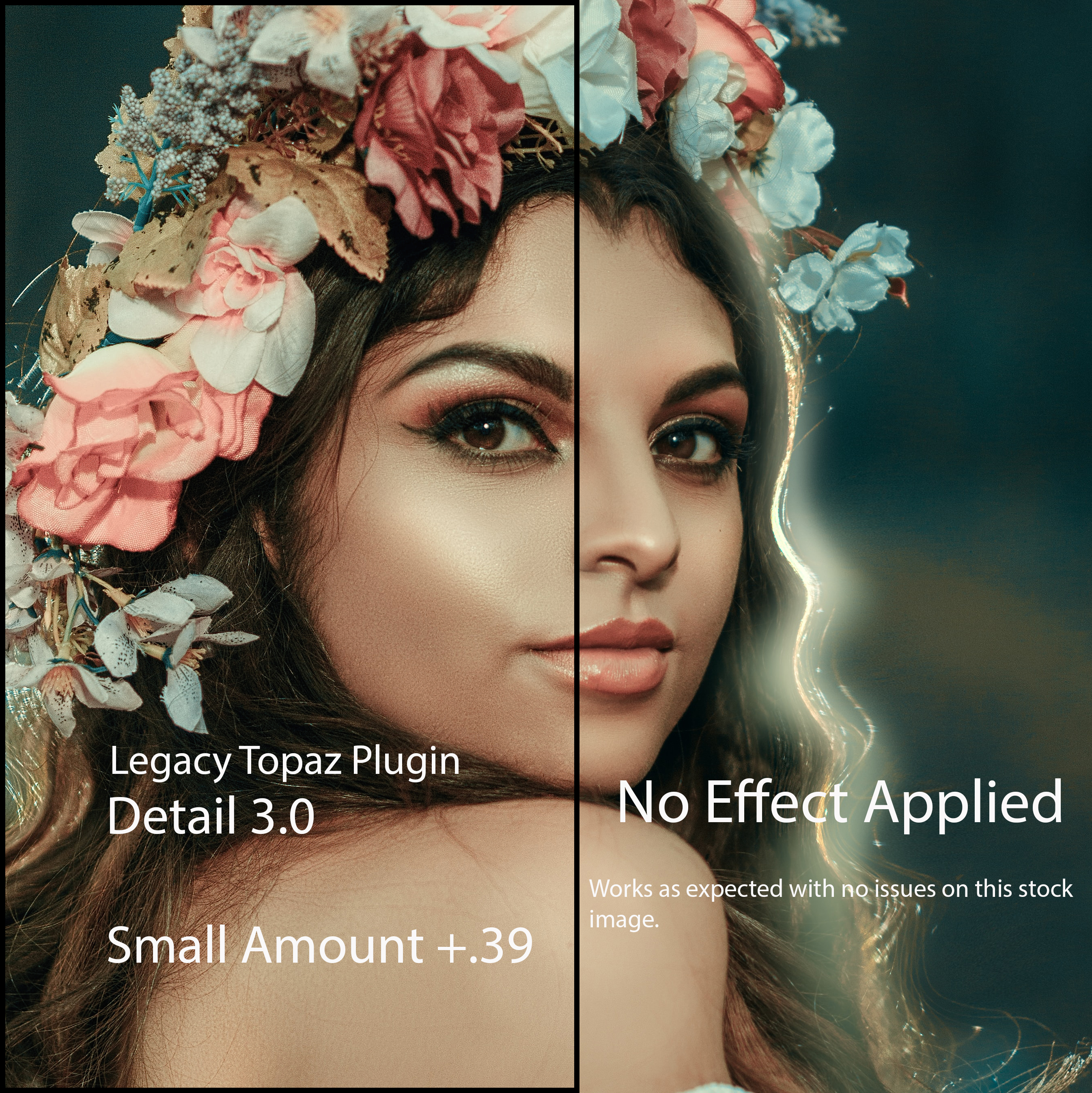

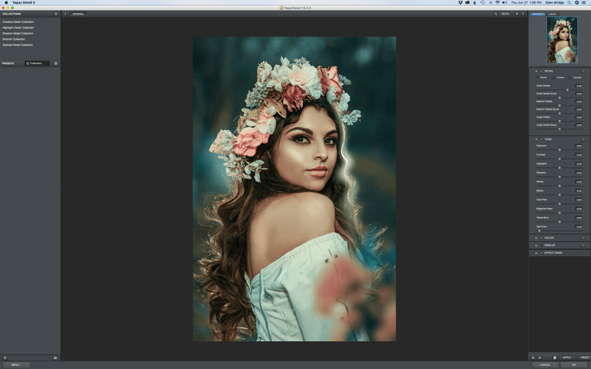

Notice Small Detail Slider set to +.39 using Legacy Detail 3.0 Closeup of the Adjust Ai Small Detail Adjustment(Right side no Detail Applied, left side detail applied) Example showing Topaz Legacy Detail 3.0 results
