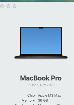

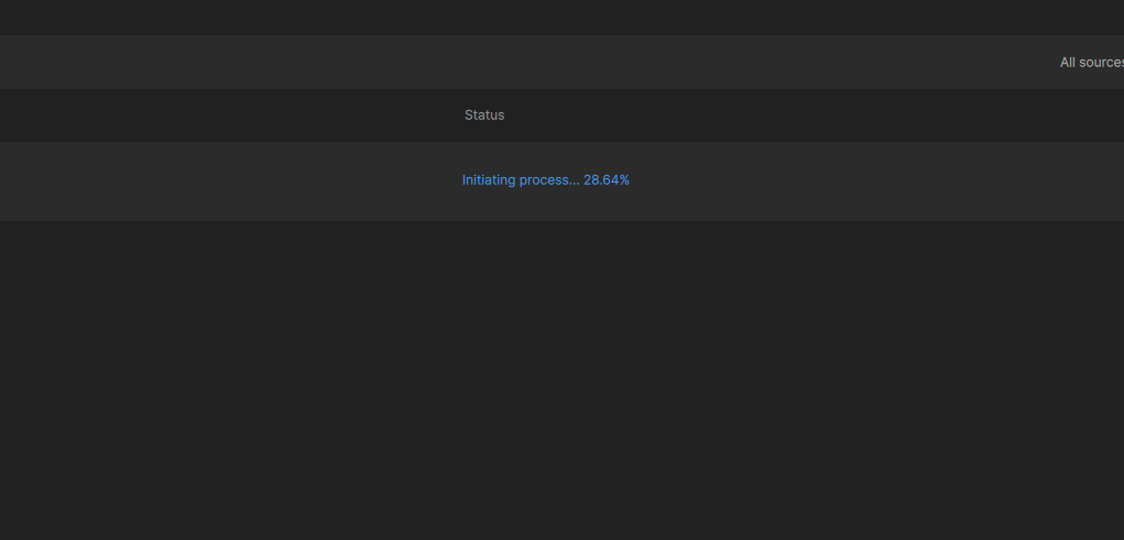

7.1.1 - When enabling Scene detection, initiation process freezes and stops

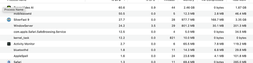

So I’ve updated, and the “initiating process” starts, but doesn’t complete. In activity monitor, the FFMPEG command disappears and it just sits in limbo.

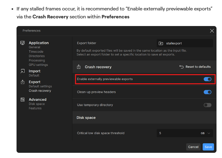

Is that feature enabled in the Preferences?
So I have done that, and for that specific file I tried before and after handbrake with the same issue. Also tried again with compressor. No dice. It seems to work without scene detection, I noticed that it renders repeated parts and such.
logsForSupport.zip (2.5 MB)
Crash recovery is already enabled.
